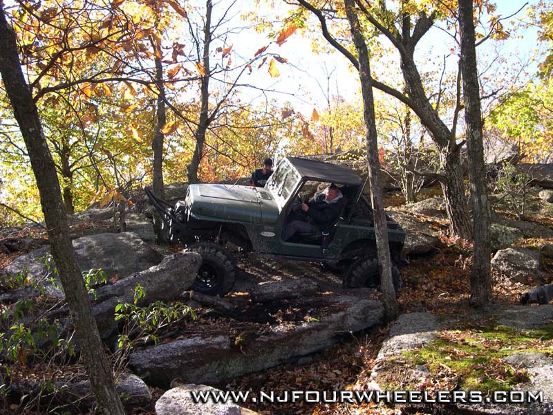

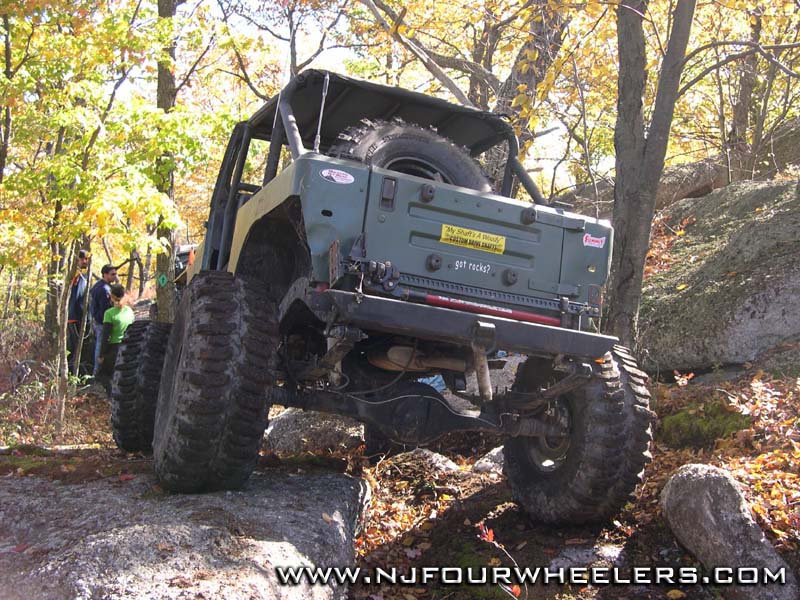

lol A friend of my unlces has a newer white Cherokee with 36" super swamper with stock dana 30,35 axles and he wheeled at paragon and rausch creek.. His name was roger and he drive a cj here a pics
Thats not a CJ, its a YJ... Nice rig though.
The cherokee has the dana axles and that his wifes truck and the yj is his and it has custom axles, and the rear is a ford 9 "

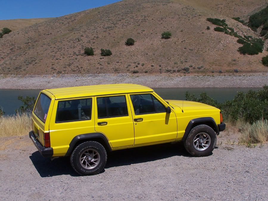

90 Cherokee has the 4.0, AW4 automatic, NP231 transfer case, D30 and D35 axles. This truck is about as basic as they came, but it is a blast to drive on and off road. My daughter drives it and can get 25 MPG average out of it. And in bone stock form, can travel almost anyplace I really want to take it. Its fairly small, so narrow tight trails are no problem. And decent ground clearance for a stock 4x4. This truck hasn't cost me much in repairs, but then, I got a 87 Cherokee for free as a parts rig. I do most of my own work, and have friends that can do work I can't or won't tackle. Depending on when I get a different rig for my daughter, this might become my next project, considering 1 ton axles, 4" lift and long arms, with 35 or 37" tires and LOTS of cutting. Low center of gravity is the goal...

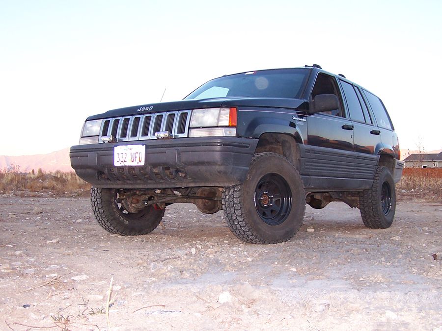

95 Grand Cherokee. Slightly bigger, but more headroom and legroom. Cushier ride, due to coil springs at all corners. This also has the 4.0, a Chrysler automatic, NP242 transfer case, D30 and D35 axles. This is also a bit heavier than the regular Cherokee. Very nimble offroad. Mine has the factory Up Country package with tow hooks and full skid plates, and a 1" factory lift. I've added 2" spacers with the coils, and swapped in aftermarket front upper and lower control arms, and now rides on 31s. But, took it places on 235/75-15s and no lift the Cherokee couldn't go. I will be adding some rock sliders and bumpers soon, so my 22MPG average will be out the window soon. Yes, 22 MPG average with small lift and 31s. I would love to snag a TJ 6 speed manual trans for this rig. And LOVE the fulltime setting in the transfer case in the winter.

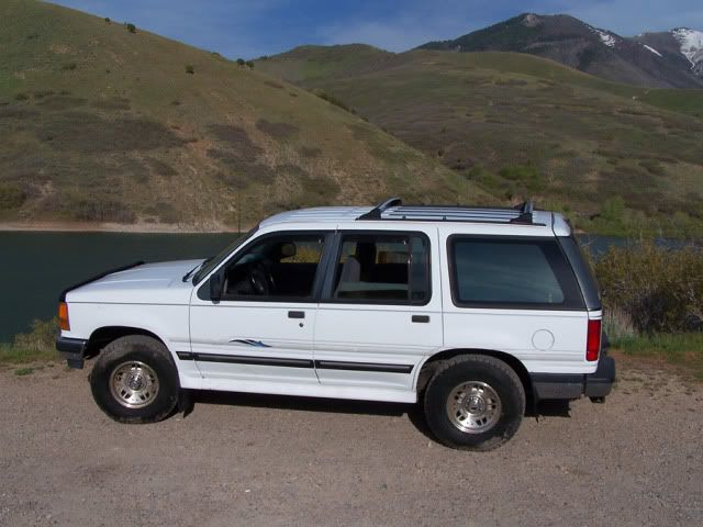

1994 Explorer. Comfortable highway cruiser. MUCH bigger than my Grand Cherokee. Taller, longer and much heavier. But tons more headroom. Still quite capable offroad, but less clearance than either of the Jeeps, and taller than my lifted Grand Cherokee. It is also a lot longer and a bit wider like the Ranger. Sits on 31s right now, but will be back on 235s soon. Its back in the garage because of a coolant leak we thought was at the timing cover, now seems to be the intake manifold. Fun, not.
