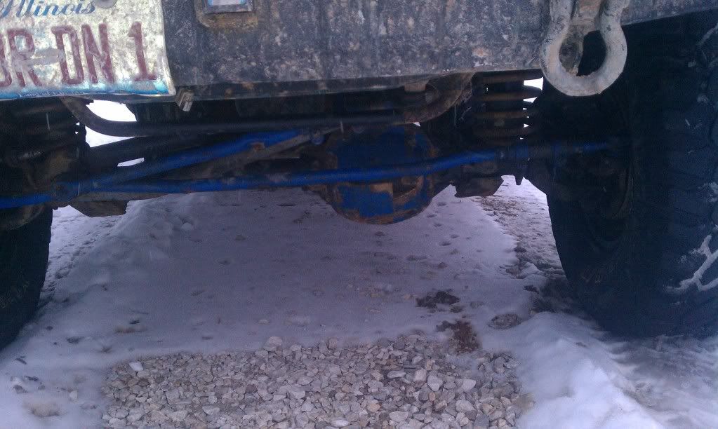

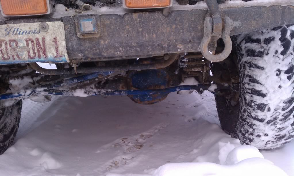

Looks like I allready have a photo or two in my photo bucket. Here's the YJ linkage on the front of my '87. It has been flipped and the drag link shortened:
I had to cut off my steering stablizer mount as it was rubbing with YJ linkage. I later fab'd up a new mount to combat some Death Wobble I was having.
Before:
Ater cutting it off:

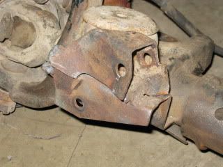

I got the stock sway bar end link bolts out of the brackets on the axle. It was no wonder I broke 3x T55 torx bits; the damn things were splined and drove in. It took a torch to heat them up and drive them out. The bracket and bolt would only come out when it was glowing red.
