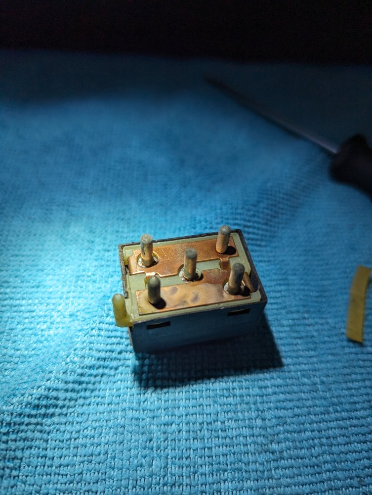

Quick update. after it rained inside my truck the other day i was getting some weird electrical gremlins. like the door locks would actuate 2-3x whenever i started it. I thought it was surely b/c some rain hit my janky passenger door switches.
so i took those apart and found that the switch contacts were pretty corroded:
kind of hard to tell in the pics, but a couple of the pins were turning green. took some high grit sandpaper to the pins, then rolled some into little tubes so that i could run them through the connector side in the doors.
here is the cleaned up pins
plugged and unplugged them into the connector side on the truck a few times to help with any residual corrosion and tested them out.
i no longer get the locking when i start it, and the passenger door lock works ~90% of the time now. i think the actual lock wire is bent and binding up sometimes in the door card.
passenger power window switch now works perfectly. just need to replace the window regulator since it needs assistance coming back up :LOL:

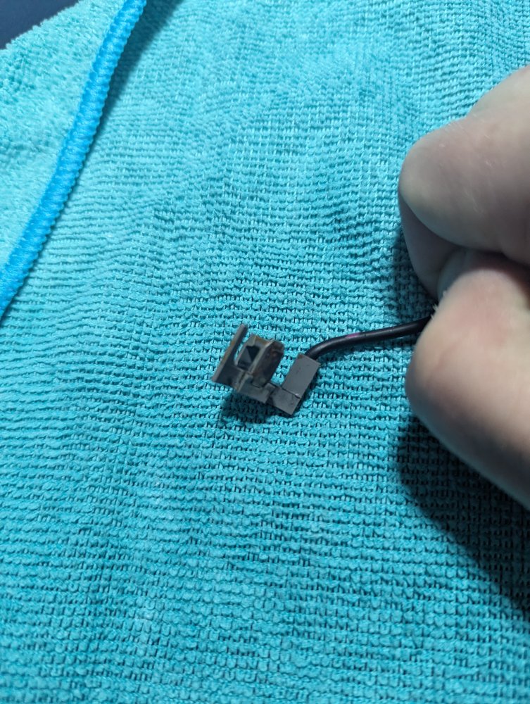

I was also hoping to grab the 'key in switch' wire from the 92 but the ignition was drilled out in a very poor manor and they clipped the wire (i snagged it just in case)
