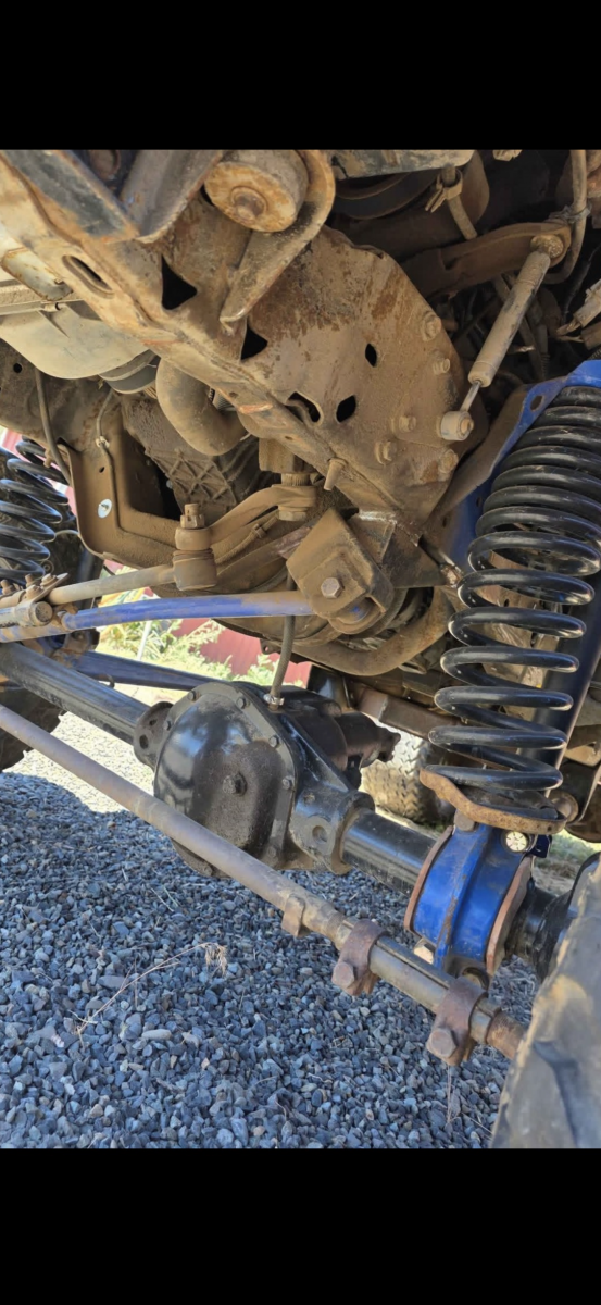

Just picked up this 92 ranger with an 88 front clip and a Dana 44 and ford 9 swap, I was an unfinished project that I have “finished” as if any project is ever finished
but I have takin it out a couple times and noticed that I have a ton of droop in the front but not much up travel and was looking at there swap and noticed the coils are not very vertical especially the driver side but the axle is centered I’ll drop a pic of what I’m talking about
That is sitting at ride hight someone I talked to said the reason for no up travel is that the coil may be binding up and I was wondering if any one has done the swap and knows what I should do to remedy the not so vertical coils was thinking about just moving the lower bucket in a hair but then don’t know if that will cause a major weak point
And help or insight would be appreciated thank you in advance
