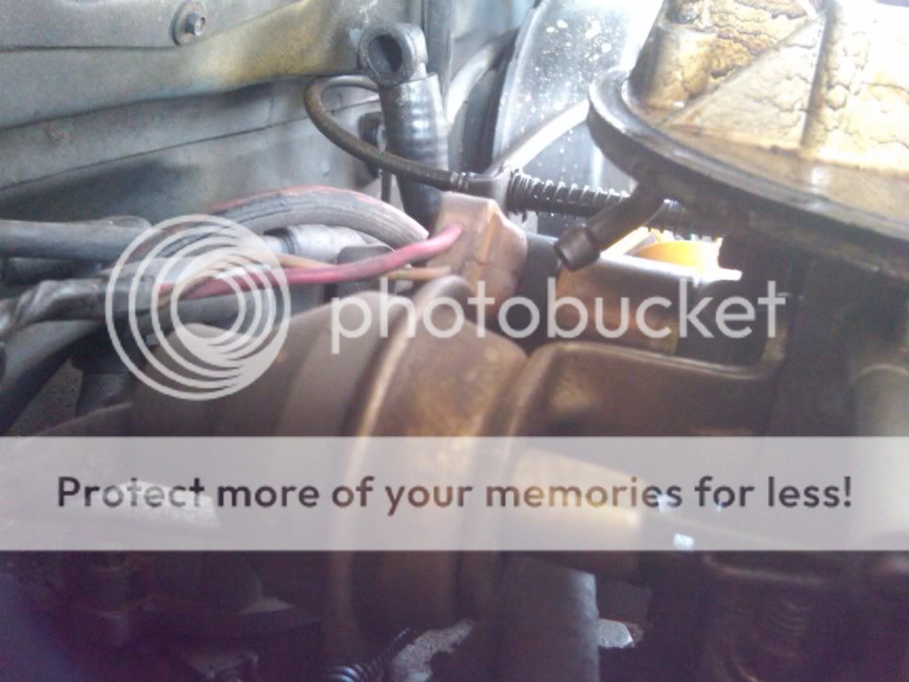

no then it would be really low im not sure if its even working lol it seems to be running fine like i have it soo all i gotta do it put a nut on that screw to keep it there and should be mint. also do u kno what goes to this looks like a missing hose or vac. line and i cant find any lines disconnected?
thats lil tube with a lip on it coming off the carb is what im talking about. and i had some things diconnected when i took this there all back on now like that black line with orange on it i put it back on
thats where you put the egr bleed line it comes from the 5th solenoid and a filter is supposed to go on the top if you look at the vacuum diagram by the radiator it is the solenoid on the top left it relieves the vacuum from the egr to allow it to close when the computer tells it to the tech library has a vacuum diagram I just checked under my hood it is the orange vacuum line if you can still tell the colors
the filter is supposed to be inside the air filter the bleed vacuum tube will get clogged and hold the egr open if it is not at least plugged into the carb
