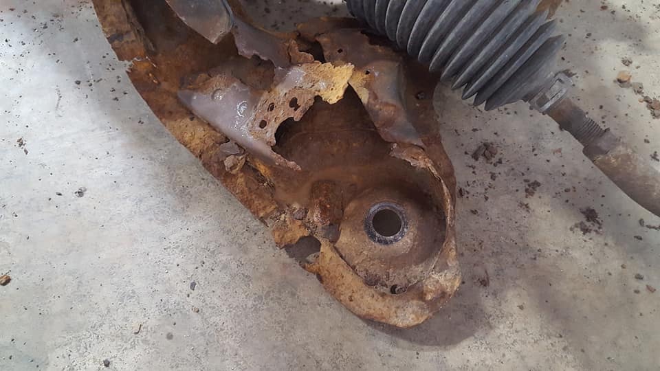

Rusted out cradles have been the demise of many many cars. Big problem with Escapes too.

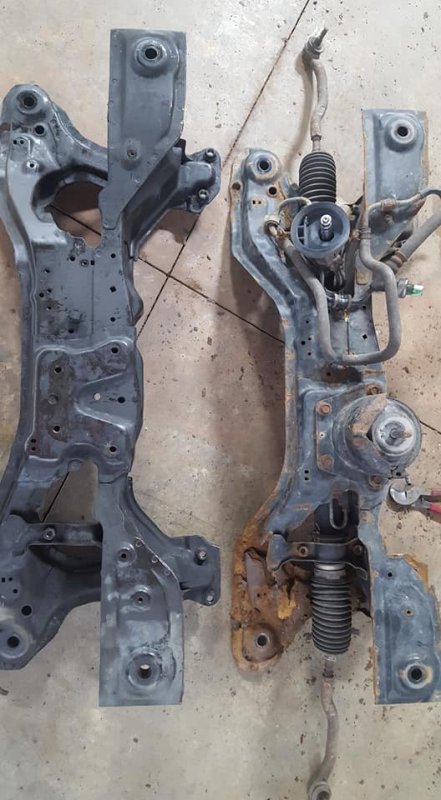

This is my '01 Accord cradle I changed out last year. Took me and my buddy 4 hours on his lift. Bought a "new" one from CA on ebay for $150 shipped. I got this car in Florida, it was likely caused by the A/C drain dripping on it constantly.
A few years ago my uncle gave me a running '99 Accord that the front half of the cradle rotted, you couldn't drive it because the wheel flopped back and forth. Wish I kept that car, but my buddy didn't have a lift at the time.
