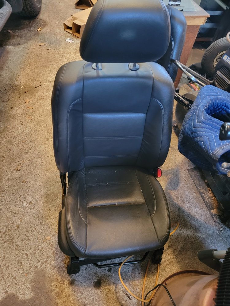

Ok, I feel like I need to explain considering $1500 for a set of bucket seats. I've said in another thread that I'm using the Saleen Explorer XP8 as part of my inspiration for this build. Well Saleen used a Recaro seat as an optional upgrade for them. I have a line on a set of those Recaros (not Saleen branded) that look to be nearly new from the pictures I've seen and power everything including heat and cooling. I haven't reached out to see if they are still available, partially because I don't know when I could go, partially because I can;t get over the price. I am very tempted to though. That price tag...
Other than that I'm going to be looking for some "race seat" inspired factory seats. The top alternative at the moment is of course Mustang. Followed up by Ford's other car products, but most if not all of them I see are ~$500, plus needing repair work, color change, and/or full upholstery. By the time I get done with a set of OEM seats I'd be in them at least $1000.

About the seats, I don't know about '99 buckets, but I know my '97 buckets are comfortable as all get out so maybe you could find stock seats (that fit) in good shape and see if they are to your liking. No heating/cooling though, just lumbar support. So they did run electric to it. I don't know why they didn't put heated seats in the stock buckets. Cooling is nice, I've had it (Saabs) but to me, I could easily live without it. If your a/c is good, that's a small cab in terms of volume, it'd cool down pretty fast. Almost might be better to put in remote start and just cool it down first?
You'd have to have the switches for the heating/cooling unless they were on the seat itself. Often they have low-med-high for the heat and maybe for the fan for the cooling.
There is a section here on TRS about seats interchange so you don't end up fabbing seat rails etc.
It just depends where you want to put your dollars and how much work is involved.
No, just no. I think the buckets might be better than the split bench, but still not what I have in mind. I want more of a sports car seat. Even if they were, finding a decent set in my locale would be near impossible. I've hit up junkyards for parts on these trucks a lot over the years. Local yards just don't get them or they are ragged out before they get there. It's not like other parts of the country where trucks rust out before they wear out, down here they wear out long before they ever get taken off the road. When the do hit the yards, they don't tend to last long before being crushed.
Have you ever lived in the south? I know your profile says Virginia which is considered a southern state for some reason, but I mean the real south. I'm taking south of Birmingham, AL or Atlanta, GA. Being down here I'm more interested in ventilated seats than heated. I don't need either, but it would be a nice/interesting addition. For my seat swap those and power controls are secondary to the form and function. The goal is to get something well bolstered and supportive for handling curves a bit bit faster than it should, while still being comfortable enough to spend a full day behind the wheel driving.
Switches won't be an issue. The high dollar seats I'm considering have all controls built into the them, just have to supply power. If I end up needing switches the head unit that I'm about to install can be use to control them if I add an additional component, and maybe a 3 way switch if needed.
I know the seat swap articles on the site. They are woefully outdated, but would also be super difficult to update due to the number of potential variables. Basically nothing in the article will work for me, largely because most of the suggestions are too old and unavailable in this area, but also because I don't particularly care for those options and think there are many newer and better possibilities. Nearly any seat I'd want to install is going to take some work adapting seat tracks.
I've dropped too much on thing way worse than a set of seats. Doesn't stop me from being hesitant about spending the money. Also doesn't help that there is almost no way to try before you buy. There's no place around here that I can go plop my backside in this set of Recaros, and I don't know people with most of the other donor vehicles I've considered to try them out either. There aren't even any u-pull-it yards in the area that I could go browse.

I'm with you 100%. Ford Ranger interiors are kind of boring. Installing something different certainly works for me. I'm bought buckets on Facebook Marketplace for $200.00. These are from a Subaru Forester, not an exact fit, but can be adapted. They are black, not that boring gray.
Some of you who live in warmer climes might prefer fabric. I dunno. To each his own. .I lived south of the Mason Dixon for many years and never felt uncomfortable sitting on leather. I find it easier to keep clean.
I dunno, never had leather. All my trucks have had fabric, except for partial vinyl on the seat of my 84 and vinyl in the F-100. The 84 was mostly fabric though and the F-100 was quickly swapped out for cloth bench from a 90s F-150. My car is "suede" and sport mesh? I think the suede is actually synthetic microfiber stuff. The Recaros are probably more of a microsuede than a leather like what you show on the Subaru sets.
I've sat on a lot of vinyl seats around work over the years and those do suck when its hot out and you've worked up a sweat. Vinyl isn't leather though.

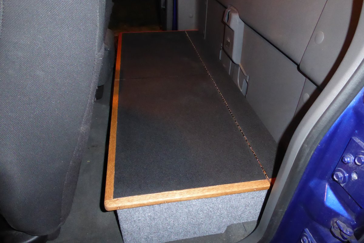

I realize this isn't in your plans but just in case you hadn't seen it here's what CrabGuy did to lose the seats but still looks cosmetically nice and there's a lot of storage space in it so the jack goes there. What he did to cover the jack holder is run a cargo net across the back.
