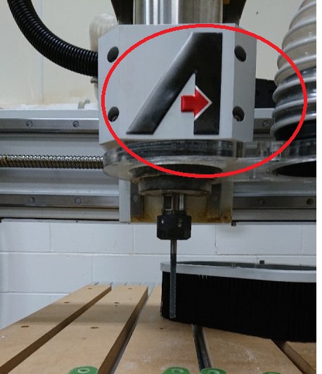

Pretty good work especially having no cnc experience. Took me 6 months of training just to get my haas 5 axis to make a basic aluminum pipe flange.
We're fairly quick learners haha. My buddy has some CAD experience and I can program in C/C++, so we hacked it together. Just need to some dremel cleanup.
Ya'll know I'm dumb, and sorry for intruding, BUT, what are these, and what do they do?
Not dumb, and not intruding haha. I only learned about this kind of stuff as a result of old forum posts on racing forums.

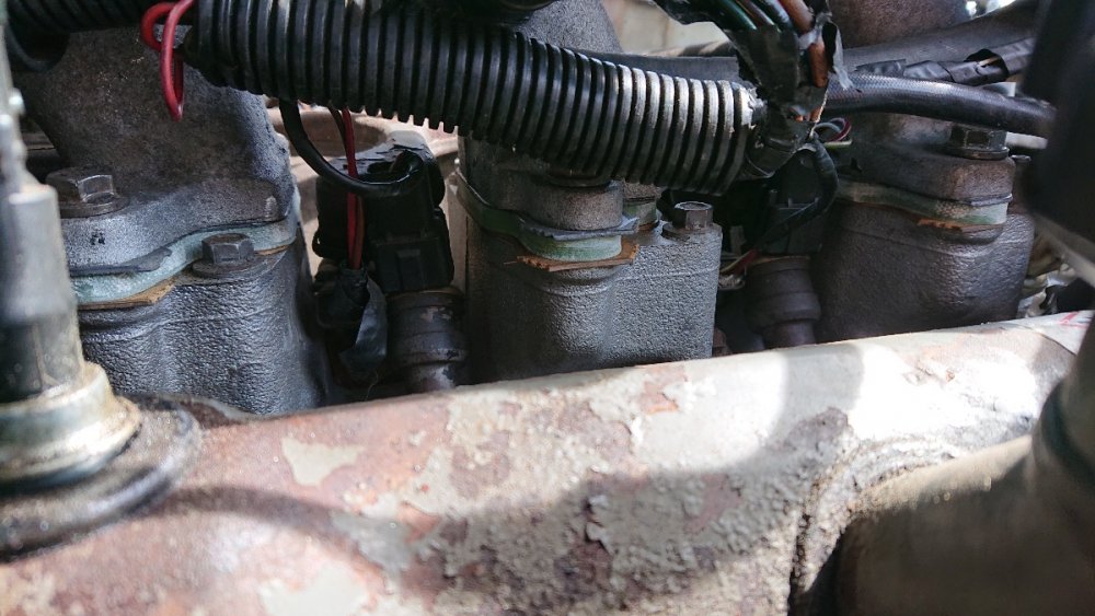

Well, according to the AFR gauge, they work.
Drove for an hour or so. Got home and parked it, 160f under the spacer, 105f on top. Woot!!
Noticed the truck ran right around 14.7:1 the whole way back, as opposed to the normal 16:1 I'm normally at once the engine comes up to temp.

Did anyone else notice this?
29554
Didn't Know the Avengers were hocking there old equipment. lol
