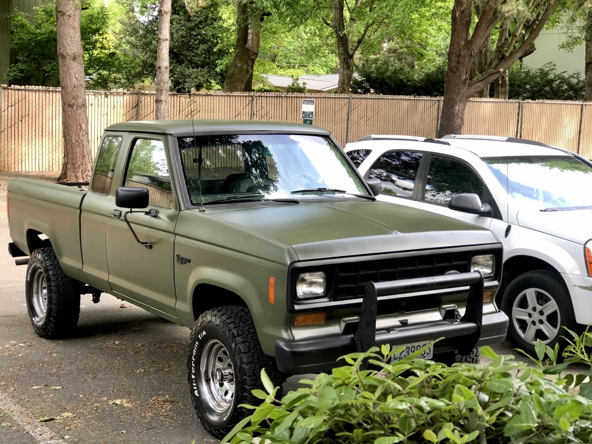

Thanks for the info, I’m definitely going to be doing digging on this motor. I’ll check out your threads for sure.
I’ve been doing a ton of work on the truck since I got it. Now that I have some direction with mechanical upgrades/changes I’m looking forward to experimenting lol.
43320

WANT
Jerk and all your rust free bodywork..... *kicks dirt*
