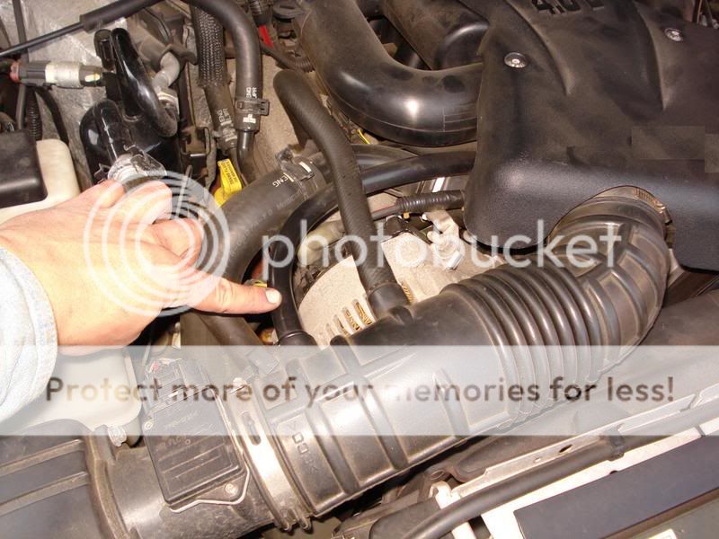

What the heck are you guys pointing out?
To get the whistly air sound you have to remove the top of the air box, pull out the filter, and whats left is the bottom of the intake and a tube going into it that goes out to the back of the headlight.
Heres a page with pictures...
http://www.ranger-forums.com/f59/how-air-silencer-removal-311/
i tried looking where they said earlier and no peice was there, thanks original ranger it worked and sounds money

I'm talking about those plastic boxes that they put in some times coming off the main duct.
The intake resonator...Did they put them on newer Rangers? My F150 has one.
