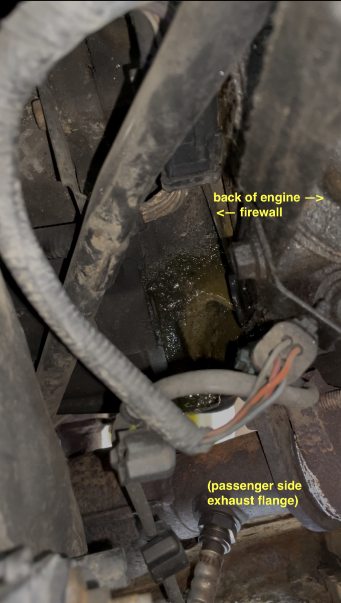

When I started it the next morning, there was a new large steady leak of coolant below the rear of the engine, dripping from the bellhousing (pic below). Can't see exactly where it's coming from above that, but I am guessing somewhere on the passenger rear of the engine/compartment. There is nothing visually obvious that I can see from above. It's a significant amount of coolant dripping, only when truck is running.

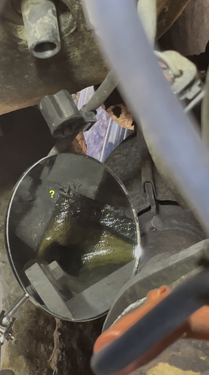

No coolant leaks at the heater hoses or components anywhere along the firewall or top of engine compartment. definitely seems to be coming from somewhere on the back of the engine. leak is a slow but constant drip when truck is off (haven't restarted it).
put a mirror down there but couldn't see above the area in the photo...

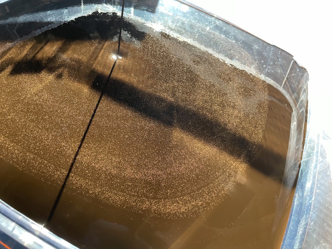

also drained the oil, sludgy and bubbly coming out, with a brown tint in the sunlight. 😐
That seems to be an excessive amount of aeration in the oil for a cold engine that was sitting... if not aeration than suspended something... except coolant doesn't suspend it would be at the bottom of the pan..
If you haven't hauled it off, I'd put a 2L into a old clear soda bottle and let it sit overnight to see if anything separates out. I don't know what to make of that honestly... it doesn't look good, but I don't wan to panic if all it is is air bubbles from draining and falling 3' from a lift down to a catch pan far below it.
thank you for saying that, I thought it looked strange also.
I didn't lift the truck to drain it, it was flowing from about 9" off the driveway. there was one ominous thicker glob in the stream early on. the oil is sitting in a clear container now, will inspect again tomorrow..
beginning to suspect a head gasket ... but also have no idea the age of that oil or history of the engine, maybe ancient and dirty or sludge from overheating previously or something else?

before you yank a valve cover, I would grab a pair of nitrile gloves and go fishing in the oil to find out if that glob is a bit of plastic/rubber that got gobbed on with sludge and turned into a furball or something worse... stick a nice strong neo magnet in another glove finger and run it through the oil looking to see if anything sticks.
