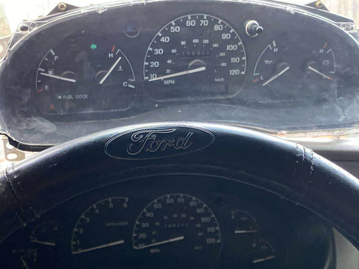

Just swapped my cluster for one with a tach, the original on the dash I’ll have no use for. If you end up needing new cluster it’s yours
Cool looking cluster
