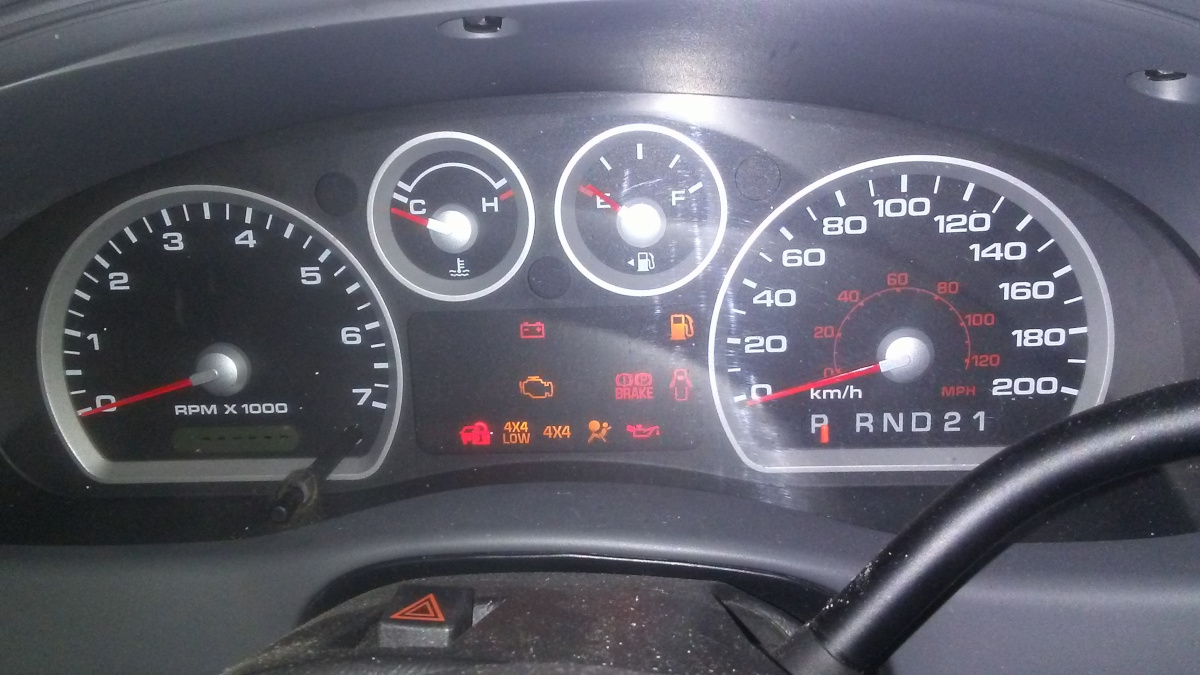

My instrument cluster has gone crazy and my truck won't start. This is an 08 Ranger 4x4. It lights up like a christmas tree, no OD and the PATS light flashes fast.

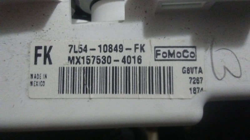

From what I have read, the instrument cluster needs to be replaced. My problem is that I have a Canadian truck and the 7L54-10849-FK cluster is unobtanium.
Has anyone ever tried an AK or different 7L54-10849-XX cluster?

Cant help on finding the replacement but I'm not sure if you are aware, the cluster is part of the PATS system on that truck. You cannot simply swap them out. The cluster has its own coding to the ECU just like the key. Ford did this because they kept getting sued for odometer fraud. The replacement cluster needs to be programmed to the ECU and as far as I know, no one can do this except a dealer.

I did the instrument cluster test by holding down the trip od reset button while turning the key to run. The speedo guage didn't move but all the rest did, so I am reasonably certain there is a fault in the instrument cluster itself.
This brings me back to the original question: Can I replace an FK cluster (which I can't find used) with an AK, BK, CK, etc cluster?

My IC failed the self-test. I held down the trip reset button while turning the key on to start the self-test. The speedometer didn't move, but the rest of the gauges did.
