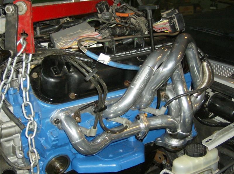

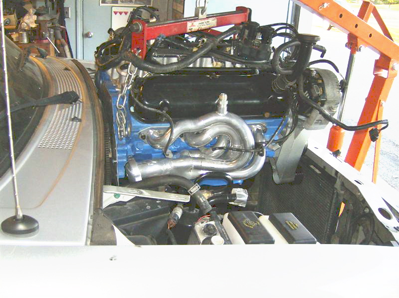

How did you guys do your sparkplug wires around those headers? Did you make your own wires or did you buy some already to length. If possible send me some pics of how you routed the wires.
I used factory wires and mimicked the stock routing as much as possible. I also adapted and reused the factory wire stays and standoffs. Boots must be carefully positioned to avoid wire contact with the primaries.
DS : #7 and #8 above the stock valve cover and looped around the back. Heat sleeves were needed on those two cylinders because of the tall TMH primaries. In the DS picture, the #7 sleeve had not yet been added.
PS: #4 along the top edge of the valve cover and looped around to the plug.
