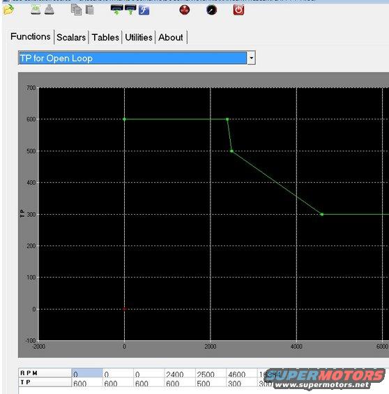

Function for when It goes into Open Loop, above the line is Open Loop Below it is Closed Loop Fuel:

Fuel trim in Closed Loop, No Fuel trim in open loop, it is running mostly off of what is set in the Open Loop Fuel table and MAF Transfer Function. This is why it is very important to utilize and monitor a fuel pressure gauge in a boosted application. If fuel pressure drops, it goes lean and goes boom! There is fine tuning done by the EEC utilizing Barometric Pressure, Engine Coolant Temperature, and Air intake Temp in Open Loop and Closed Loop.
I tried an FMU in my first build without a tune and it was lean at low throttle with high load, it predetonated and took out a head gasket. The MAF Transfer Function is a curve, not linear like boosting fuel pressure.
