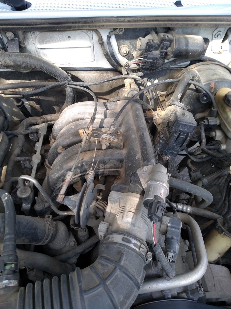

There is an anti-diesel screw on the throttle linkage that you can adjust that will hold the throttle open a bit more at idle
Seen under the linkage in this picture: https://www.ranger-forums.com/attac...how-do-you-remove-throttle-cable-p7190004.jpg
A little green blemish where the screw meets the throttle stop, that screw/bolt is the anti-diesel screw
You WILL need to reset this, and you will get codes and or running issues long term after adjusting it
Fuel injected engines can not use "idle screws" because there are NO JETS to suck extra full from with higher idles, which is why this is called an anti-diesel screw but "looks like" an idle screw
So there is a small risk of running engine TOO LEAN at idle, but not a problem for a few weeks
IAC Valve is used so the Computer can control idle RPMs and adjust fuel mix accordingly to avoid LEAN conditions which melts pistons and valves
Anyway, remember how much you turn this screw in to raise idle, so you can reset it after fixing the idle problem
