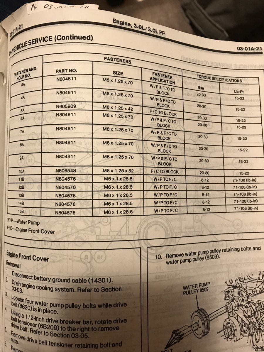

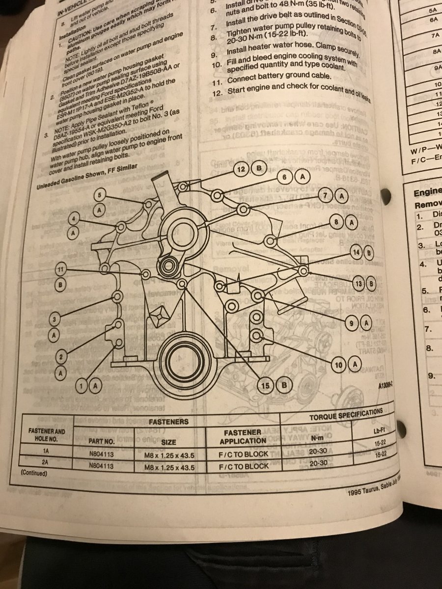

best I can do is from a 1995 Taurus factory manual. should be very close if not identical.
In need of a water pump bolt
There are m8x1.25 and a few m6x1. I'll reply the length of them in a minute, just gotta run in the garage
