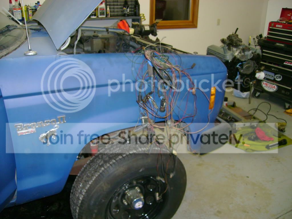

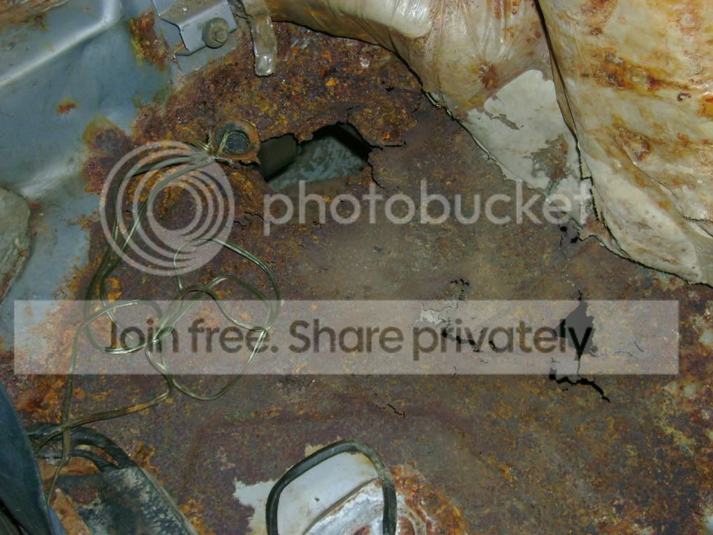

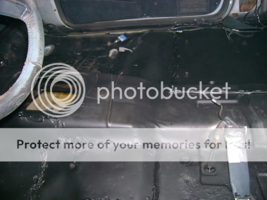

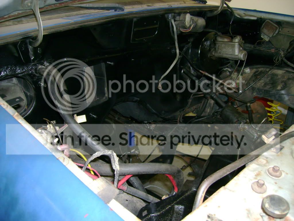

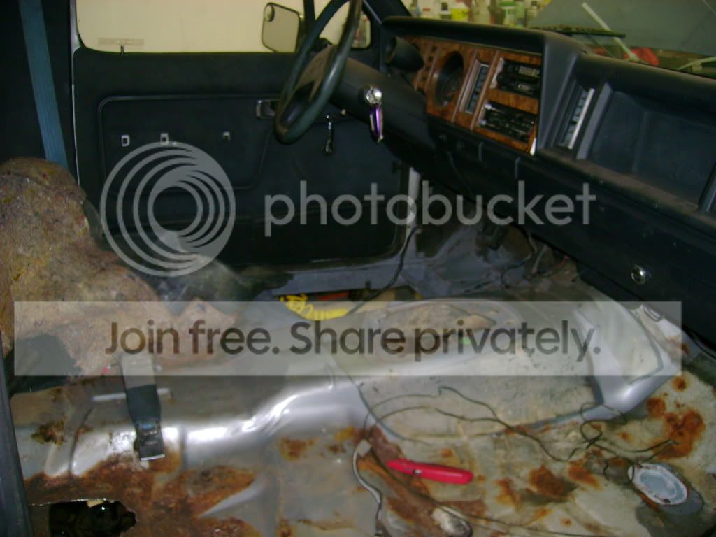

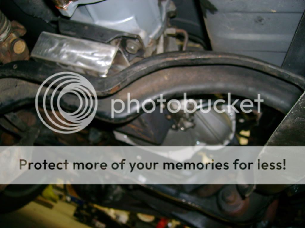

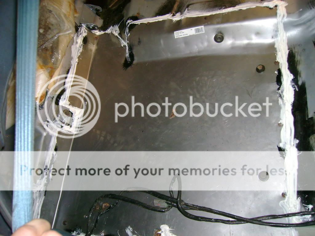

So I've been wokring on prepping my BII for a 302 transplant. It's pretty close to putting the engine in.. here are a few pics of when I first got it and began dealing with rusted floor boards etc... I will post more pics as I get them uploaded to photobucket.

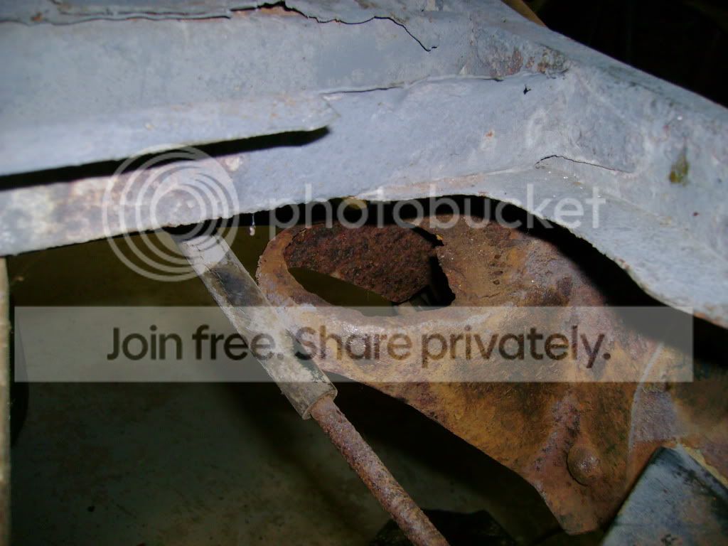

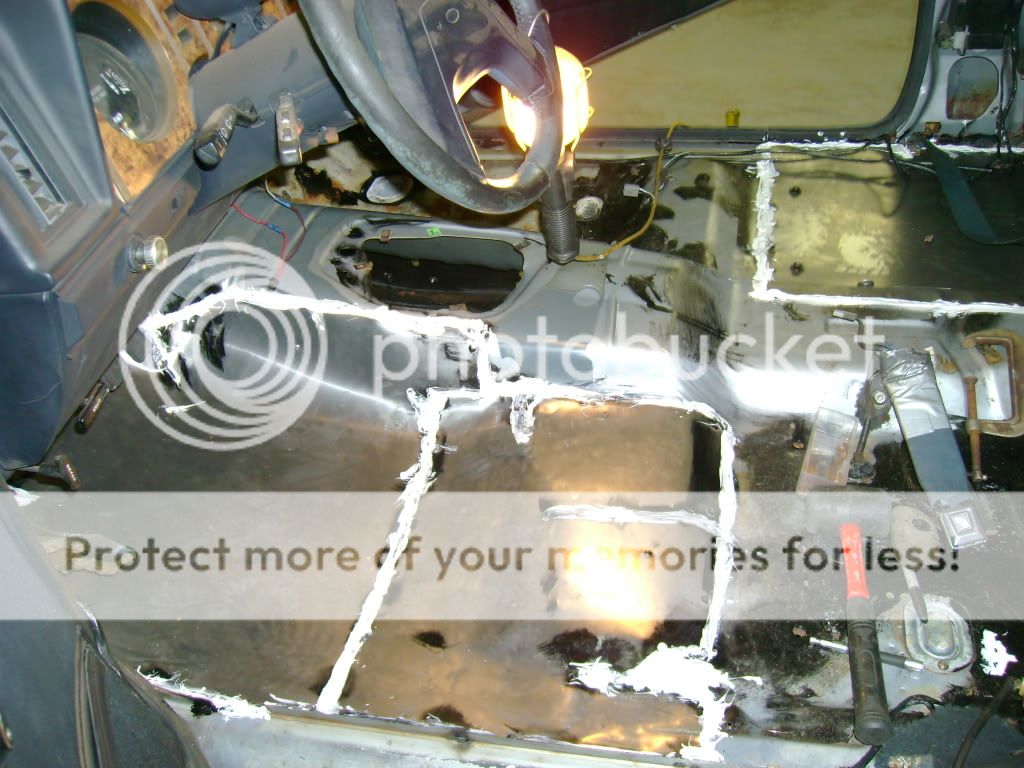

Had to weld a flat piece over this and re-drill a hole...
Ohio rust is a floor board killer
Wow, that's a lot of rust! I used to drive through Ohio every week to go to Maine, and from OH up through NY I even saw many newer cars and trucks rusted through. Keep us posted... we like pics! :icon_thumby:
Wow yeah that is a lot of rust. Looks like you have good plans for it. Good luck!
more pics! rust sucks i will have to sandblast my cab. i hate salt

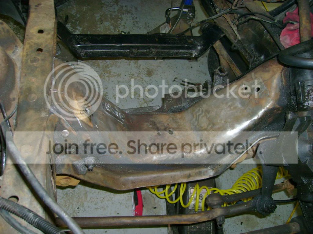

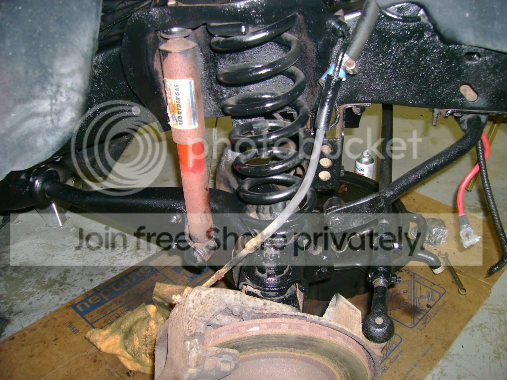

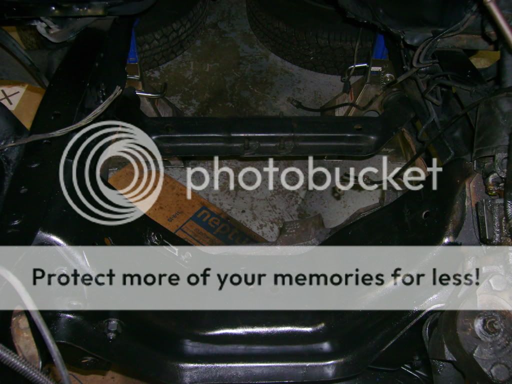

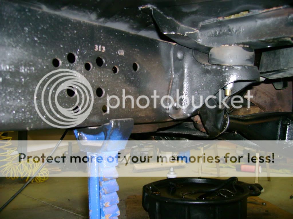

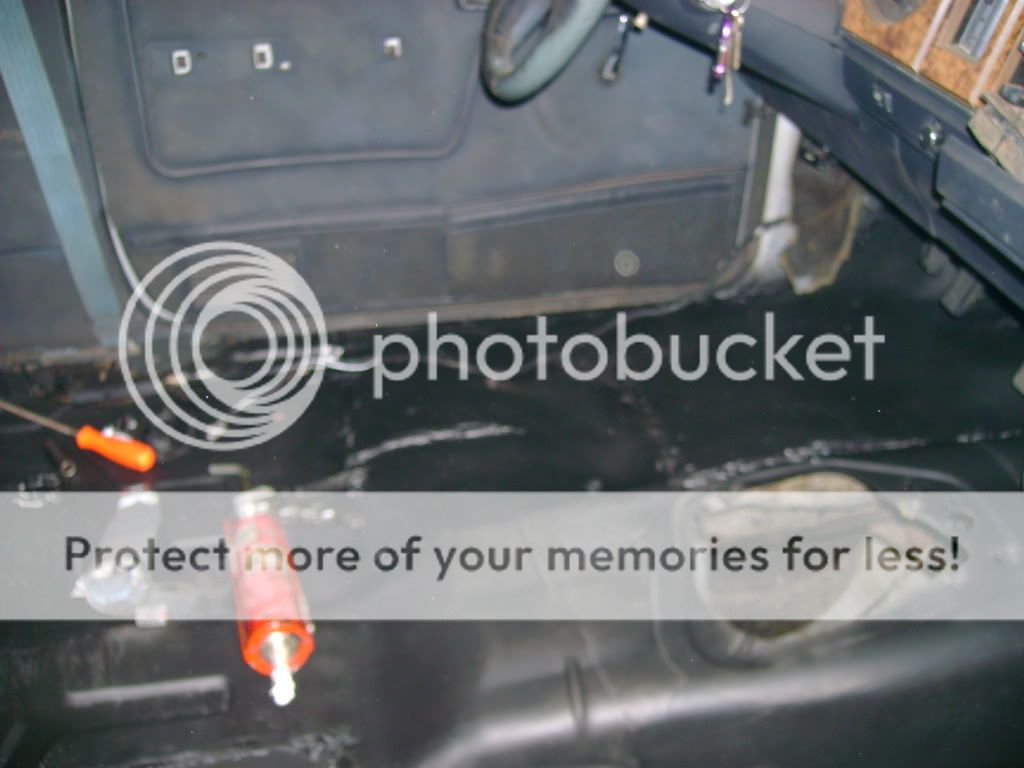

Those first pics were taken early Feb. During the rest of the month of FEB I got it to the following point:

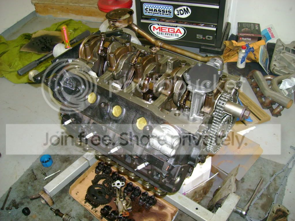

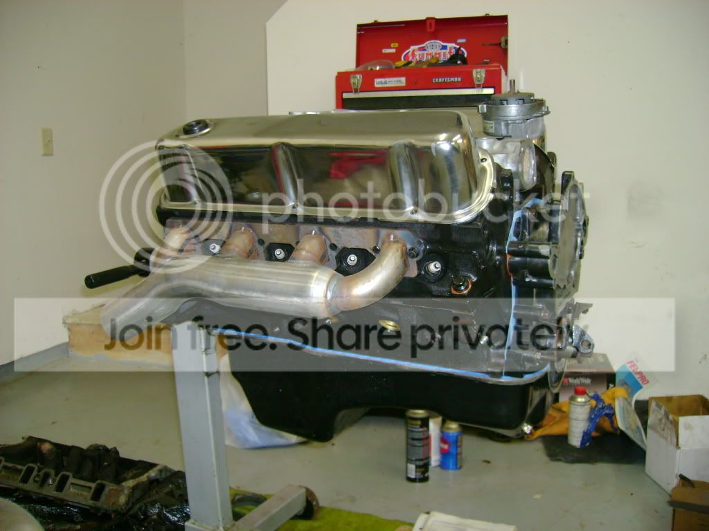

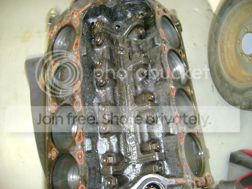

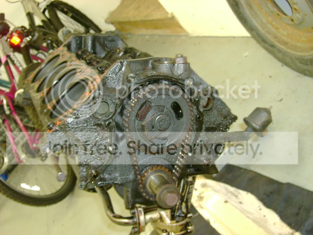

The engine im using is a spare from my 90 mustang gt... This engine was neglected/abused by the previous owner... lots of sludge and excessive wear.. I had it honed, hot tanked, freeze plugs, cam bearings etc... before installing new rings bearings..... it has a ford explorer cam shaft, E7 heads with only 40k (from another mustang) Decided not to go too crazy with it just wanted a fun toy to tool around town in.
Has anyone else used these headers in a 4x4 swap? These are the Advanced adapters headers... the only reason I am going to use them is because I bought them for cheap off of a guy who had planned to do the same swap but backed out.
if they wont fit you can always bend the ends in some to squease them in there
Cool.. I will find out how they fit later this week... hopefully. I am currently debating on which route to take for the carb. I have a 2 barrel motorcraft 2100 that needs to be rebuilt which could probably be done fairly easily and cheap.. or I was thinking about going all out and buying a truck avenger 470...:dunno:

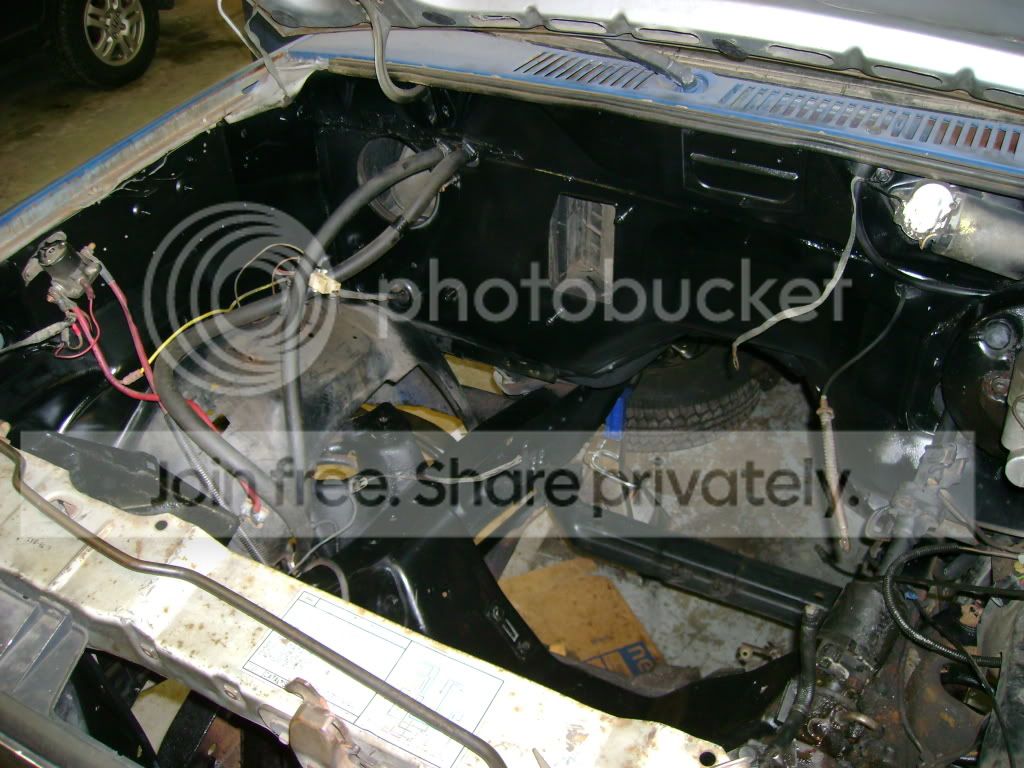

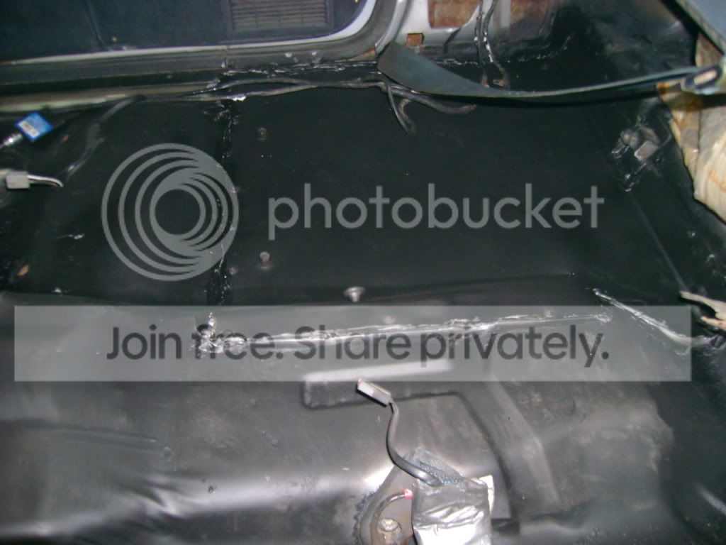

nice job on the floor pans..what is the black coating you used
Thanks.. the floor boards were not something I really wanted to deal with at first, but it was actually kind of fun to do.
As for the black coating - I put POR15 on the seams and places subject to future rust, then I top coated it with a flat black 500 degree temp paint... I figured it may get hot in some places due to exhaust, so the temp resistant paint would probably be well suited.
Good to know on the Header fitment :)

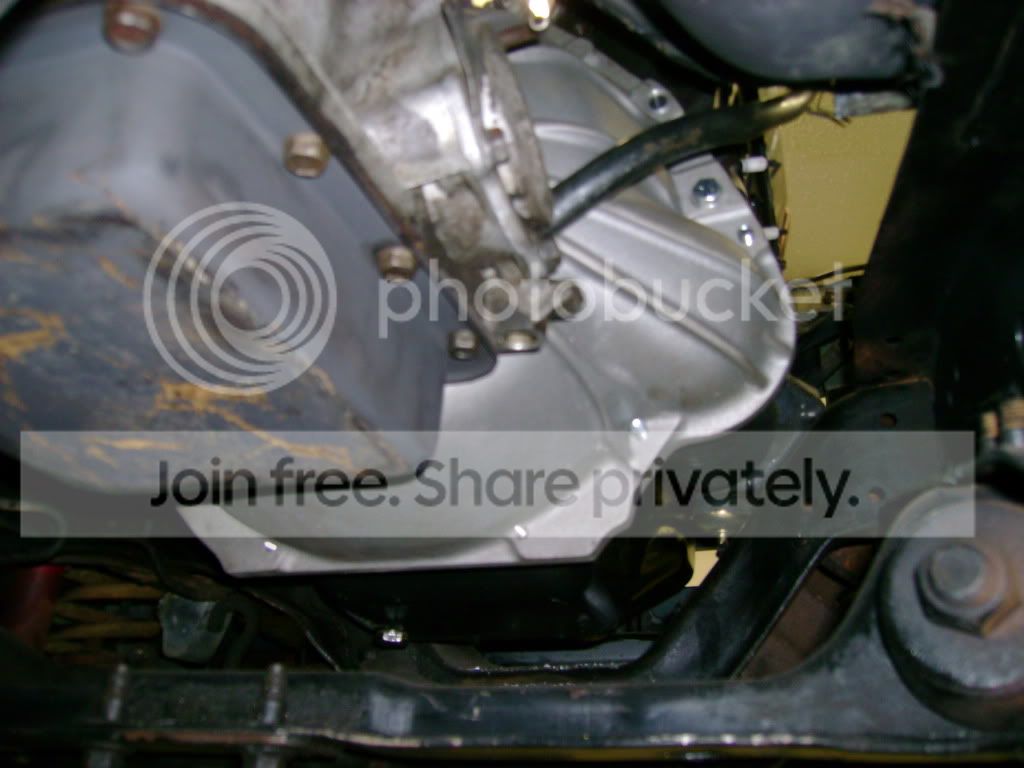

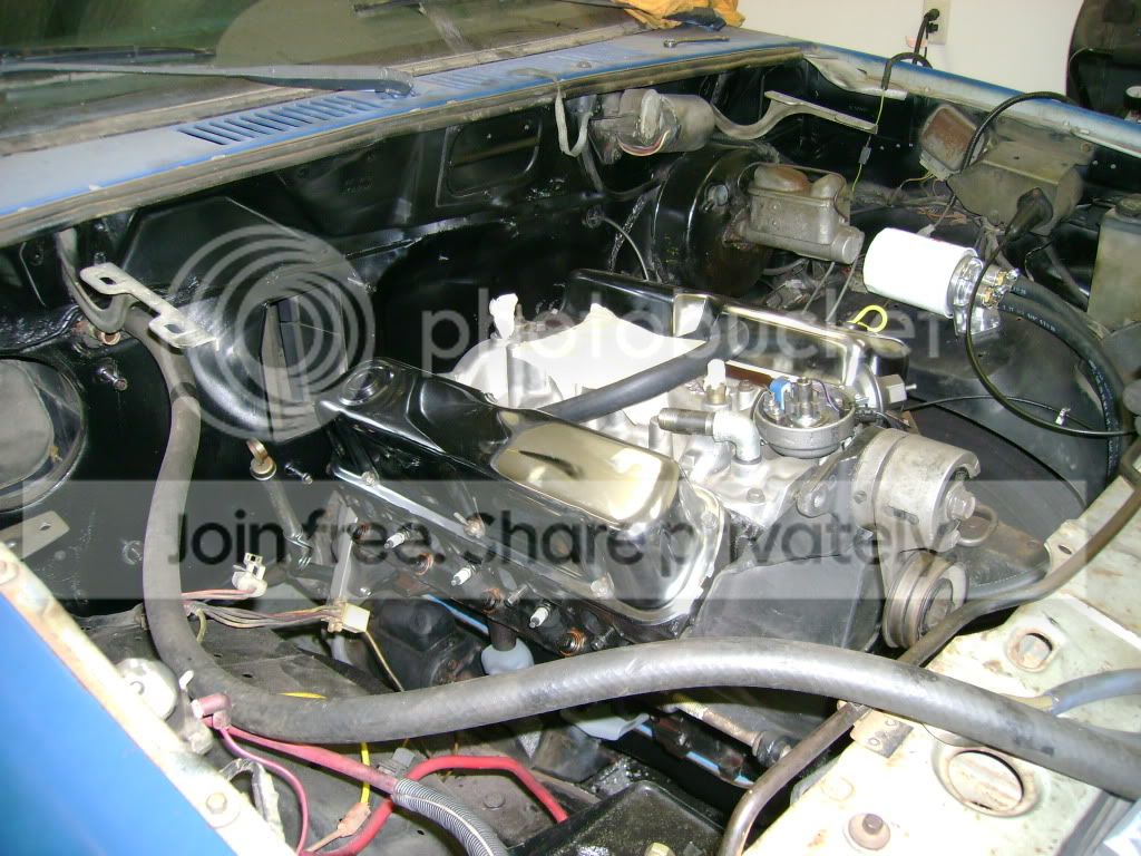

I will be mating the trans, flexplate, TC, and engine today

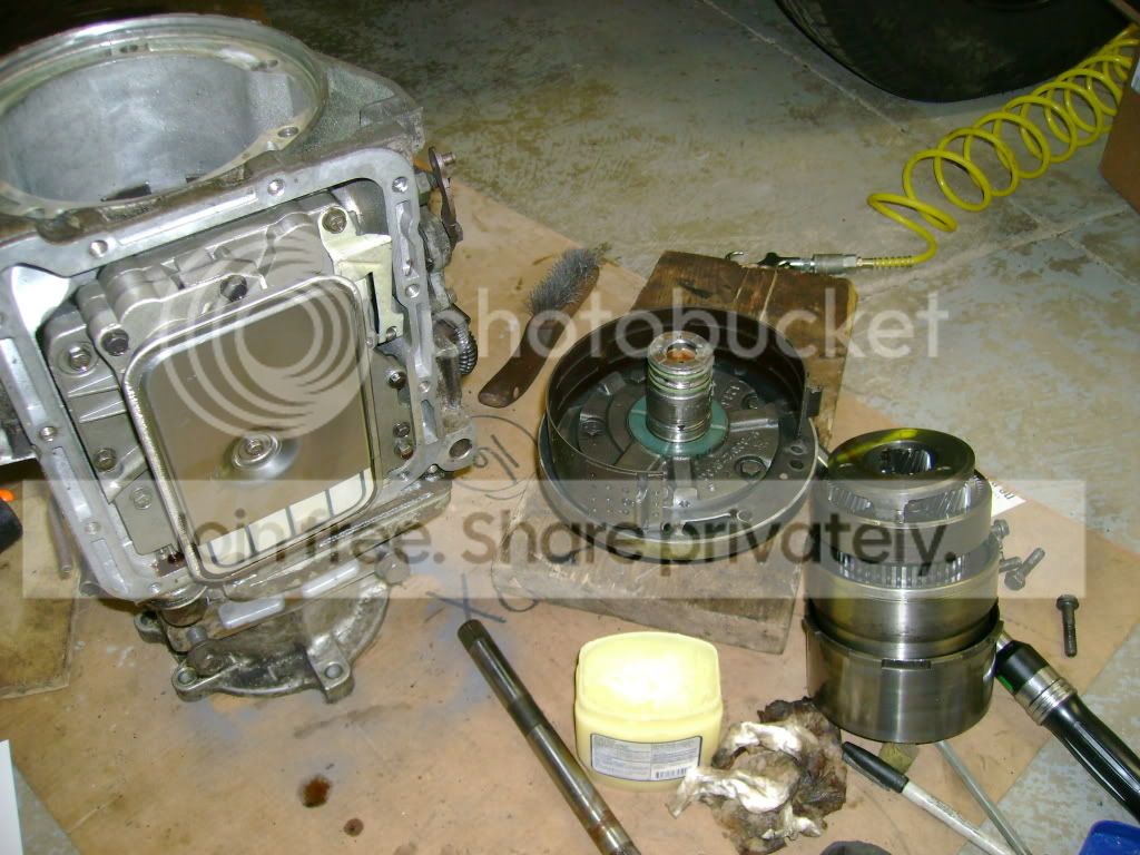

Refreshed the trans and installed the JW 157 tooth bellhousing.. the engine got the 157 tooth flexplate from summit racing with 50 oz imbalance

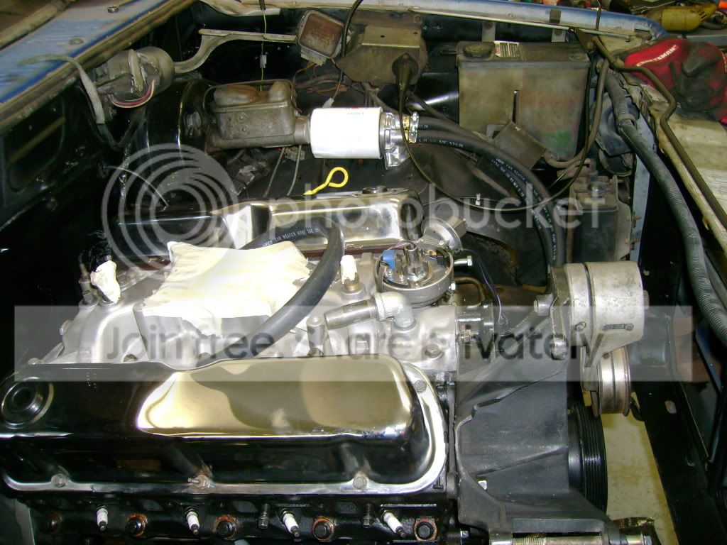

still a good ways from running but having it in the BII provides a burst of motivation :icon_cheers:
Update... got the fuel lines ran, and truck avenger 470 carb. just waiting for a few parts in the mail and the rest is down hill.
In the meantime I will have to find a power steering and associated brackets for the belt setup. I would like to do this on a budget. any suggestions for donor cars etc?
