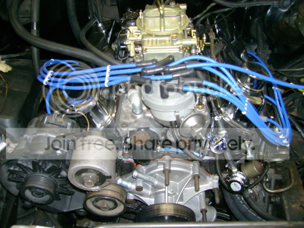

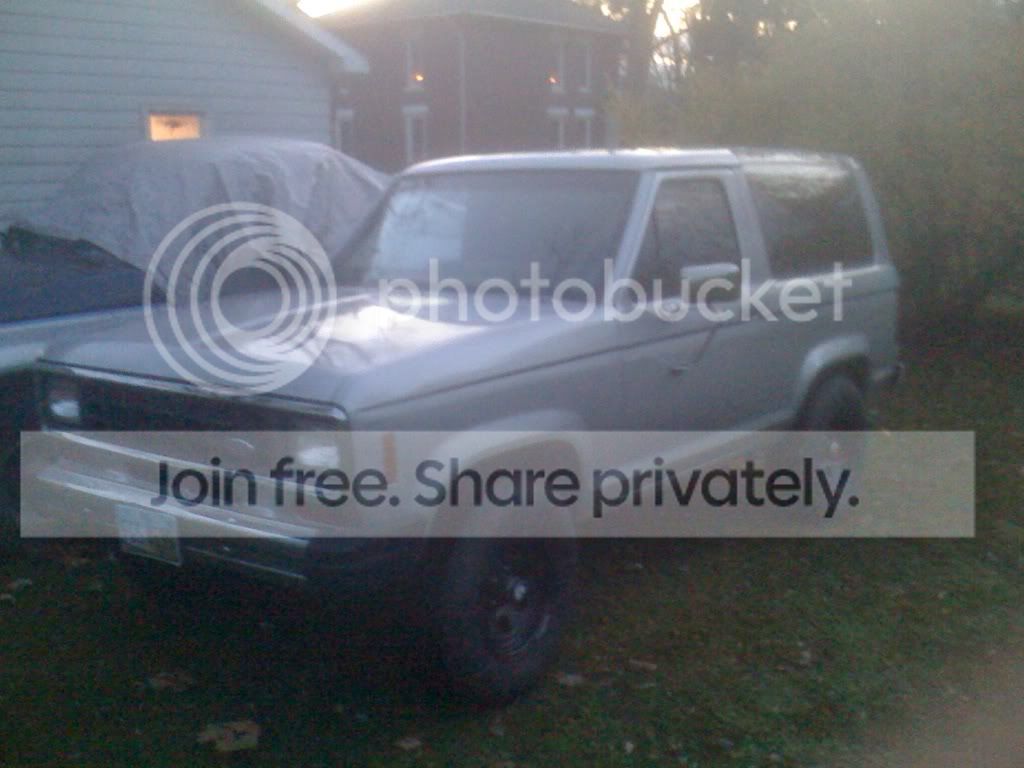

These pics are old,let me know if I can get a better one to help,Ill be under the hood of it tomm to fix a FPR leak and I can take some new ones.
It runs! :icon_hornsup: I've got it to the point where I fired it up... and got oil pressure...didnt let it run long at all because the radiator along with other small things need hooked up.

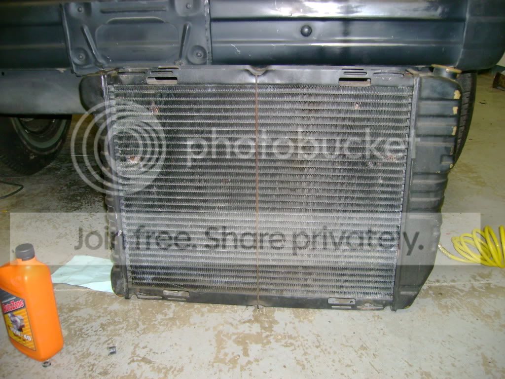

My main concern is what should I do for a radiator and fan? I have looked around and it seems like there is no easy solution that will fit nice and cool it adaquately without core support mods or using pusher fan. :icon_confused:
I guess it's not a big deal but i'm uncertain on which route to take. I want to have enough room to put a transcooler in front of the radiator.

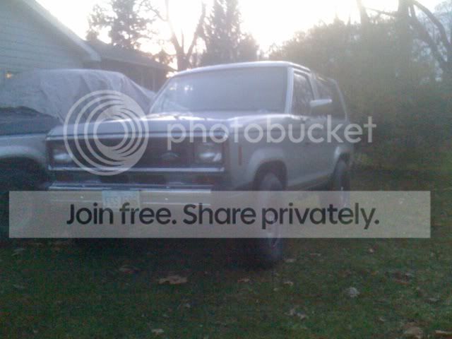

at any rate here are some pics!

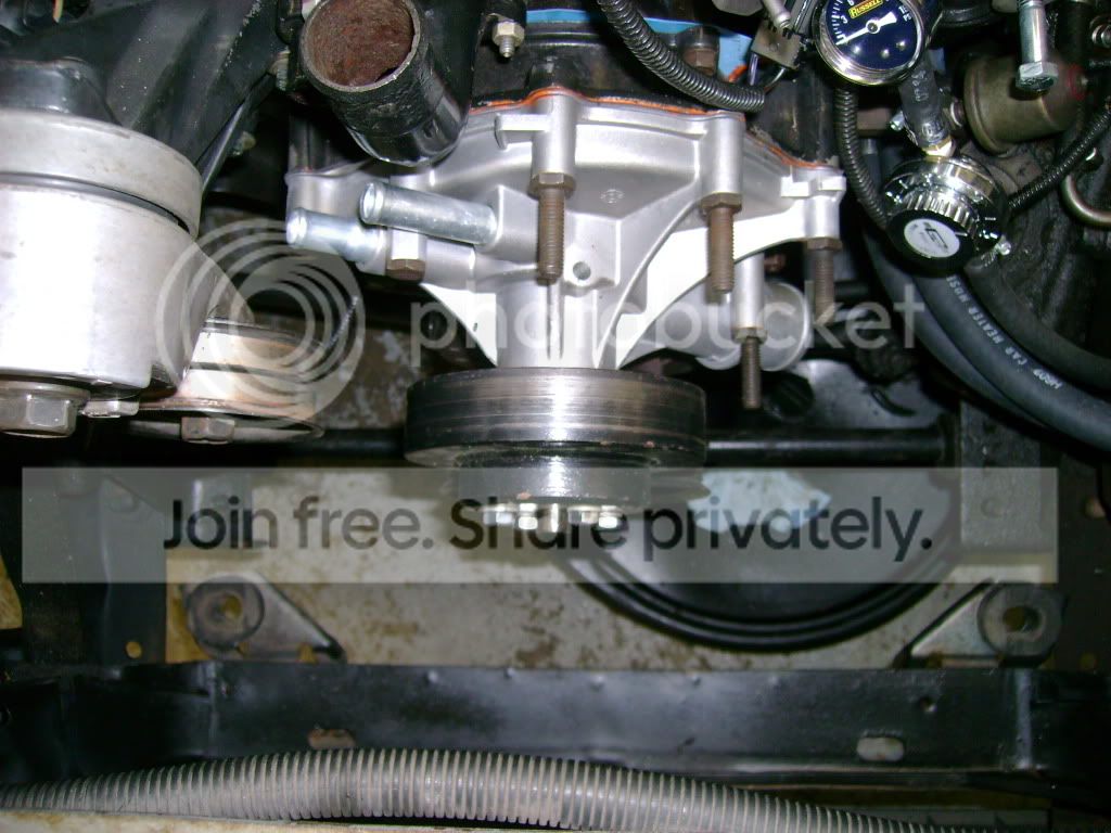

This gives a good idea of the space limitations for the radiator.

Here is a radiator from an old ford with a 390... I think it can cool it no prob, but with this one a pusher fan must be used as there is not room for a mechanical flex fan.

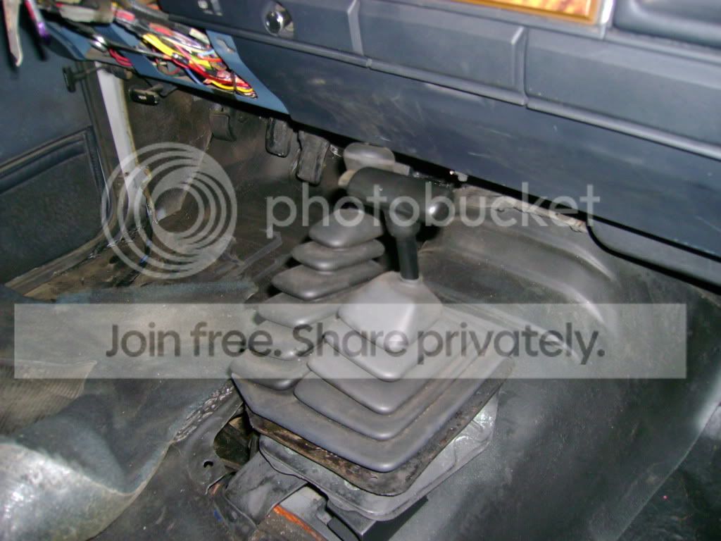

I used the shifter from a 89 mustang GT with an AOD. This took some modding to fit it in and make functional but I like the stock look it gives.
What a bronco, thanks for posting. My ranger needs one of these put in it.
I see your toolbox is also a 5 liter, very good.

I ended up keeping the stock single core radiator from a 92 explorer. This is a very small radiator, a direct fit, and when used with a pusher fan. ( i used a procomp pusher fan about 36 bucks on amazon) it works well. The temp never gets too hot even on 80 degree days.

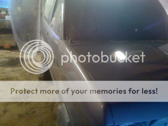

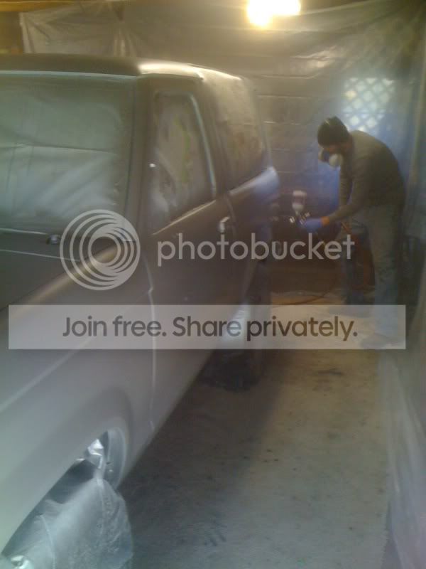

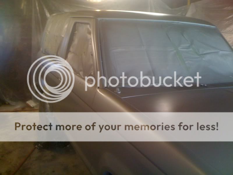

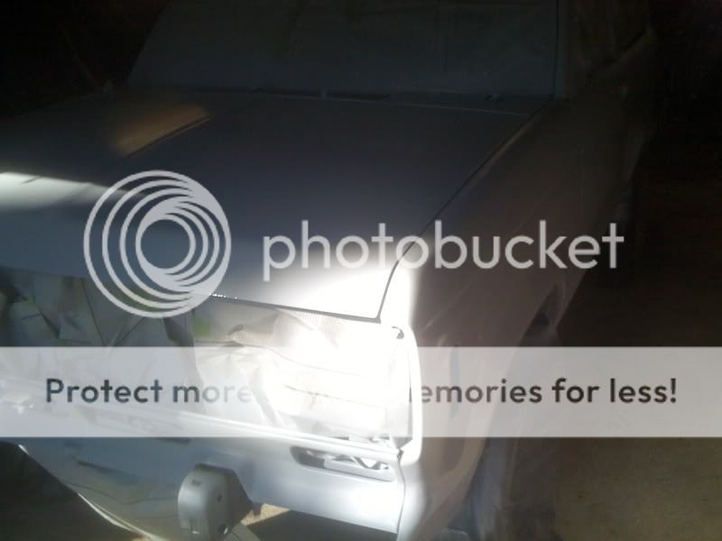

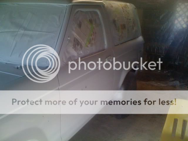

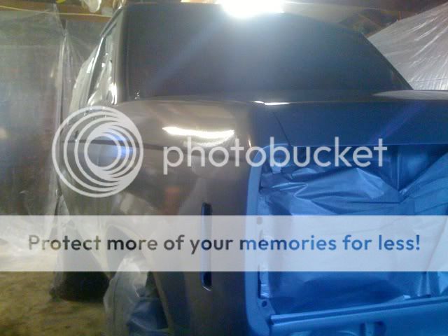

It's been a while since I've had a chance to do anything, but I finally got the BII painted. I went with Ford 1G silver metallic. Here are some pictures.
