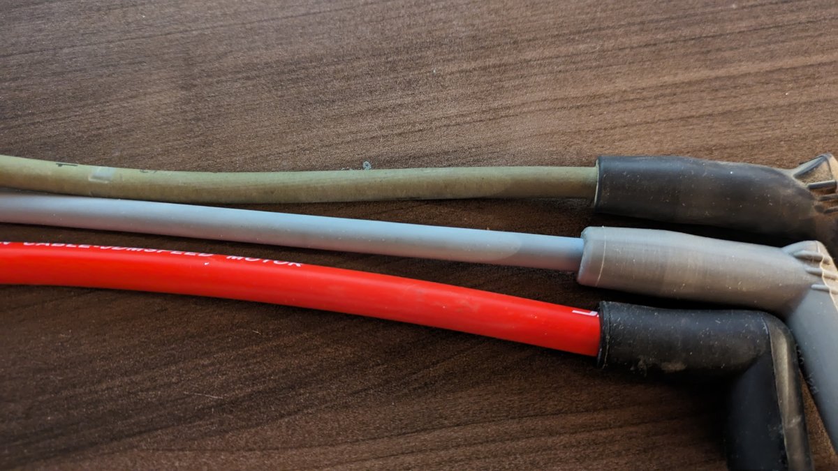

I was able to scavenge the boots from the original set, they're indeed 8mm Motorcraft parts. Since I've gotta keep my truck in a running state, I only had time to replace, scavenge the Motorcraft wire's boot and connector, and fix it to the new wire.
The setup looks kinda goofy right now but the wire works! New plugs haven't gone in yet, I've gotta keep my truck running, and I had a few more pressing matters like attending to the girlfriend's Toyota.
I'm glad I have the wires from Standard Motor products as a backup, but I'm happy that I figured out how to make the JDMspeed wires work. They were originally for a GM setup HFI setup I think, they're basically the cheapest 10.5MM spark wires you can get, they're made in China, but I've used em on proper Mazdas, and GM 3800s and they've been rock solid. They're also insanely thick to the point of being kinda inconvenient. Take a look:
Here's the resistance of each wire, I chose one of each set that was similar or approximate in length. Here they are in order:
  1. Original Motorcraft wires, after god knows how many years: 4.1K Ohms
  2. New Standard Motor products Pro series wires: 7.9K Ohms
  3. JDMSpeed wires with the Coil side boot swapped: 0.9K Ohms
Ohm ratings are gonna differ from wire to wire, and increasing with lengths. Needless to say a pretty big difference, props to the original wires for being so good!
