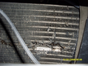

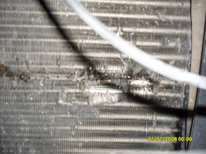

During one of the tugs, the hook that's attached to the other truck comes loose, and starts flying towards my truck. It flies through my grille, and punches a hole through my radiator.
I finish the job of pulling this guy loose, then I stop my truck and have a look at the damage. The hook damaged (cracked) the grille a little. And it seems to have bent a row of tubes in the rad back about 1.5", as well as flattening a lot of fins The thing is, my Rad doesn't seem to be leaking coolant. There's no steam, my coolant level in the reservoir seems to have remained the same throughout the night and my truck's temperature seems to hover about where it should.
I plan on replacing my radiator come spring, even if it IS okay. My truck is an '06 and I want to keep it nice, you know. But I want to wait until summer, because it's just too damn cold to do any work on my truck during winter. In the mean time, it's my daily driver. So, I'm planning on getting a bottle of rad sealant, and keeping some coolant in my cab. You know, just in case.
I'm just amazed at the quality of Ford products these days ( I had a long string of imports before I bought my Ranger). I mean there is some pretty visible damage to the rad, and it seems to be okay.
What do you guys think? Is there some other symptom that my rad is actually punctured that I should look for?
i'd say you lucked out. i flash-froze the rad in my B2 by taking off before the water was warmed up enough and now it has about five pinhole leaks that spray steam when the engine gets too hot.
That sucks - I would definitely think about replacing that radiator NOW regardless of whether or not it leaks. Just between heating up and cooling down could crack it where it's bent. Adding stop leak will just clog up your cooling system.
Its not leaking coolant because you didn't smack the radiator. You hit the AC condensor. I'm positive it leaked out most, if not all of the R-134A. You'll be needing a new one. You could have possibly gotten away with it, and not caused it to leak, but obviously its not a good thing it looks like you hit it with a baseball bat.
Radiator = fine
Condensor = mushed.
Radiator = fine
Condensor = mushed.
How do you know its my condenser? Is the condensor in front of the radiator? Keep in mind that this hole is on the driver side of the truck. So, if my radiator is fine, and my condensor is pooched, what happens with my AC?
When I have my vent system on defrost, which in this climate is all winter long, I think my AC compresser is running. Is this okay? Or should I figure out a way of shutting down my AC?
Generally speaking, the condensor is always in front, in just about all cars and trucks. Secondly, the tubing and the way the fins are I can see it from a mile away. It looks to me as if the hook hit in between the two tubes, literally forcing one up, and one down, just bending them. I don't see any cracks, but obviously I'm going off of a picture or two. I'd be surprised if there was not atleast a small leak, however you may have gotten lucky. If your AC compressor is still staying on when you turn the heat on, your fine. Looks to me like you got lucky more so then anything. When it warms up I'd throw in a new one just in case, otherwise you'll be alright.
Right on, that's great news. So i should be okay driving it for a few months as is. At the very worst, my AC system goes kaput, right?
yeah, pretty much.
if you're really worried about it, disconnect the electrical plug from the compressor so it doesn't run without oil.
I'd disconnect it anyway. All it does is drain power and gas mileage, and does little to nothing. You'll be fine. Who the hell needs AC with snow on the ground.
My bad, I should have known that was not the radiator.
Your AC runs in the winter with the defrost on because it is designed to do that. It keeps the windshield cold until the engine coolant is warm enough to keep ice from forming on it. It also keeps the air conditioning system lubricated (which is why car makers used to advise running your AC for a little bit each month even in the winter.)
disconnect the electrical plug, NOT the belt.
I think that if it lost the R-134, the compresser wouldn't run anyway - low pressure cutout switch would be open.
For starters, your A/C condenser took the hit, not the radiator. If the condenser does leak and all the freon is lost, the compressor will not work. Need a high enough pressure in the line for the A/C system to work. Also, the A/C is used in the winter to remove moisture from the air. So the inside windshield won't fog up. Problem with that, A/C doesn't work too well below 40*F outside temps.
And for kickers. Its cheaper to replace the radiator than the A/C condenser. Especially the servicing the A/C system will need after replacement.
