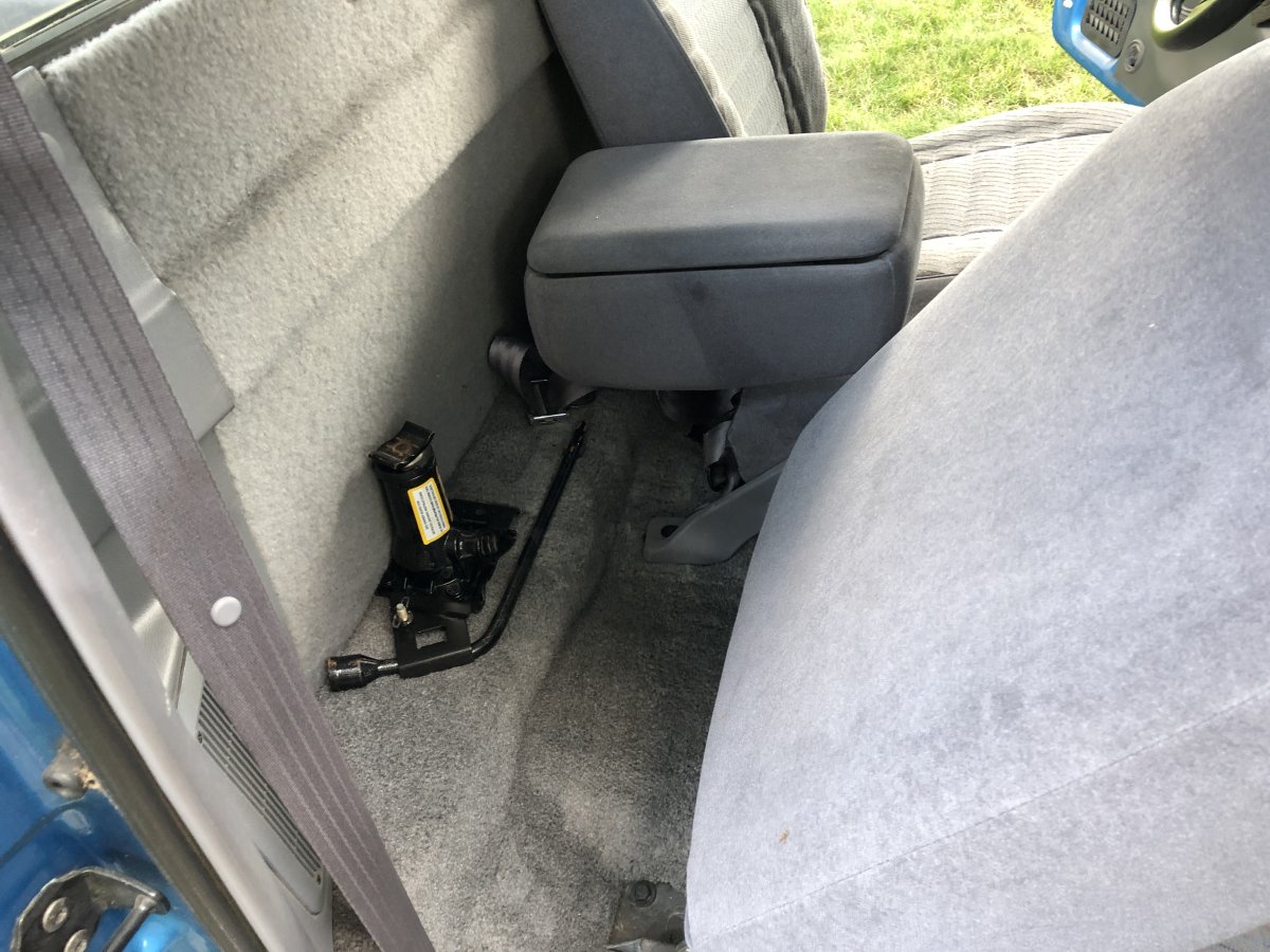

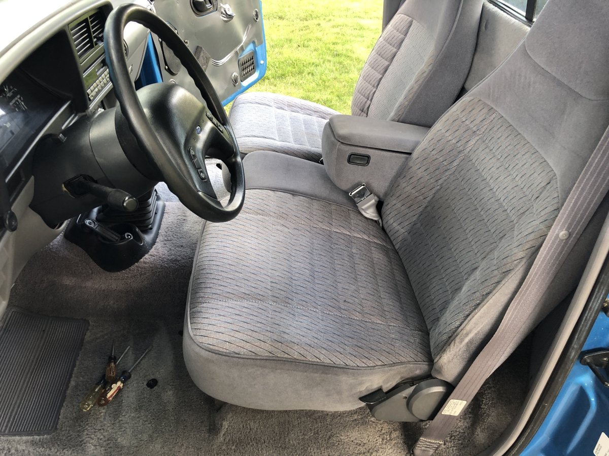

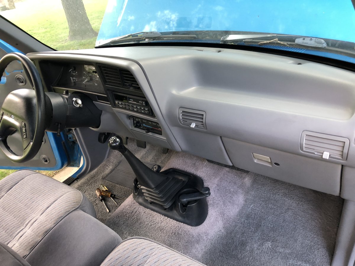

I'm pretty mad at myself as of now. I've had the head back since Friday and still haven't started on it. Somehow, I lost one of the head alignment dowel pins. I've gutted this shop looking for the lost one, but I'm left wanting. Ordered FelPro replacements, but not expected until tomorrow evening. So now I'm doing upholstery and carpet trying to stay with the project. the seats and carpeting really didn't look terrible, but I was amazed at how much dirt and filth was pulled by the extractor. I'm left without even a single stain anywhere. It's in great condition. I also pulled the door panels to chase down some rattles. I found that the plastic stand-offs that are molded into the bottom-rear of the door for the screw hole were snapped off. Melted them back in and bolstered up with some JB-Weld epoxy. Also going to add some foam padding in strategic spots to mitigate the rattles.

Nice job on the interior cleaning.
The upholstery from these years seems to hold up really well.
The shadows in the pictures make it look stained but in person, it's incredibly clean. I'm quite happy with it. I ran out of my normal stuff and took a chance using diluted PurplePower and those upholstery brushes that attach to a drill, then rinsed and pulled it out with an extractor. Came out really good.
