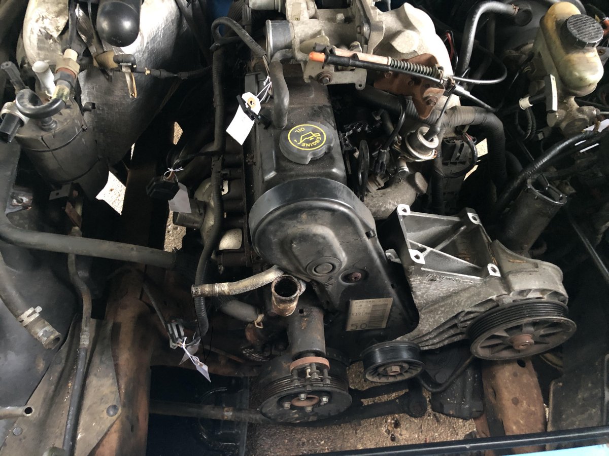

Slowly but surely... and I have to say, that AC/power steering bracket was a real %&*^&)#$#@%$^*&*)
There's a lower bolt on that thing that is a nightmare if you have large hands. I think that one bolt took me half an hour to get out.
It's convenient for me since I work from home. I have a desk and office in my workshop, so I get to take breaks and step outside and work on it a bit during the day as long as I'm not getting harassed by the phone. Been raining a lot so it's a bit slow going, but I should have it pulled this coming weekend. I WAS just going to take the head off and leave the block in there so I didn't have to bust the transmission loose and everything. I dunno, I'm still studying the thing. I may just get all the harnesses and hoses detached and pull the intake off with the head.
I'll probably tackle the timing belt and stuff tomorrow if the rain lets up.

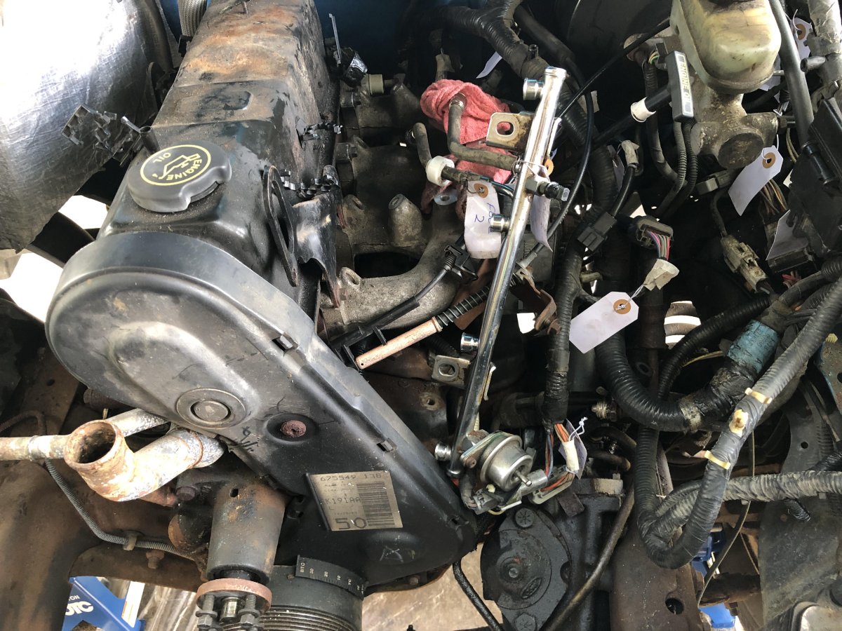

Slow going, lots of rain, overload at work and my mom got into a serious accident and broke her neck (C2 vertebrae so it's pretty serious). Getting started back on this now, still in disassembly mode. Right now I'm stuck on a fuel line disconnect that won't come apart, spent a couple of days fighting it so far. Ordered a different disconnect tool set from Lisle so we'll see if that gets my anywhere today. I did get this awesomeness delivered this past week. Bought from 3 different ebay users, but I'm in for all 3 manuals for 80 bucks.
I have a couple of different brand or styles of disconnect tools; usually one type will work where another type wouldn't.
A a lot of times you do need to blast the crud out from around the spring with spray carb or brake cleaner.
And make sure that the hose isn't pressurized- that will hold a spring and keep it from expanding.
If your tools don't work, try this before cutting a hose. On rare occasions over the years I've run into a Spring-Lock (Ford's name for the AC or fuel disconnect) that wouldn't budge; with any of my tools and even after cleaning, and even after cursing at it. I was able to disconnect these oddballs by taking a small piece of thin shim stock, deburring the straightest "working" edge, and rolling it into a cylinder. I used an open-end wrench to push the cylinder into the coupling, and it's tendency to unroll pushed the spring back whereas the specialty tools wouldn't.
If you get desperate, it's worth a shot.
Well, since this is just a spare project vehicle, there's no mad rush so I will most certainly go get some brass shim stock and give that a try before I cut it. I'll do whatever it takes to not cut it, I know the regret will run deep one day if I do. Thanks for the tip.
I have blasted it out quite a few times with brake clean and doused it with pen. oil over and over, it's just not cooperating. I saw one guy chop up a sharpie marker lid and used that as a release tube and I think it worked becasue it is somewhat flexible and might be doing what you described since it is thinner than the specific made tooks, so if the Lisle tool doesn't do it, I'll try that, then move on to the shim stuck idea.
That's good idea too.
You've got the right attitude, and therefore you will succeed.
Thinner may be the key here. I've had better luck with the cheap tools myself. Maybe that's why.
Ok , I"m done with it, it's not coming off. My fingers can't take anymore and I've tried everything I know of.
Is there a repair/splice kit for these if I cut the end off? As in, something that can be crimped on and done properly, or will this require an entire new fuel line run?
edit
Well now that I'm past my rage-post, I turned my brain back on and instead of fighting on, I disconnected the OTHER end of that return line and just left it attached to the fuel rail. It's still stuck on there, but that's how it's going back when I'm done.
Man that thing is stuck. I may even try to find one at a boneyard before i re-assemble. That kind of stuff bugs me.
