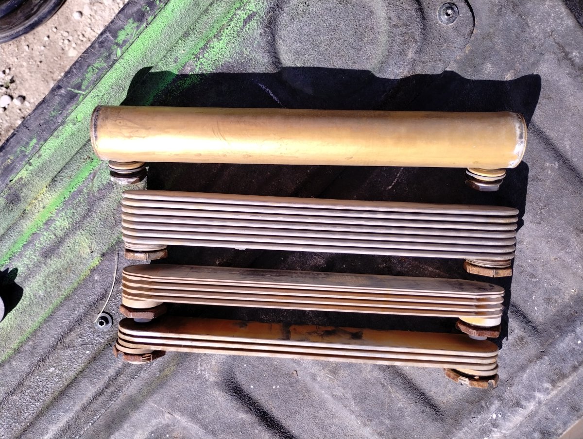

After a period of time almost all manufacturers phase out the manual versions without the cooler. Consolidate to one part number for both models, and nothing gained by getting rid of it.
The transmission cooler is straight fluid to fluid in the end tank, it does not go through the core. A little bit of that tank volume is lost, but no effect on the cooling capacity of the radiator. Even the lost fluid volume is not very significant.
Pic of fluid to fluid heat exchanger for transmision. I happened to pull apart a bunch of rads the other day. At least one of the 4 was a ranger rad. The others were various, from i4 to v8.
That's actually pretty neat, I've never torn one apart to see what's in there. I'm guessing that little 2-row job is prob what I'm dealing with. I guess I am fretting too much about little things. I warned you guys, I have lots of stupid questions. hehe

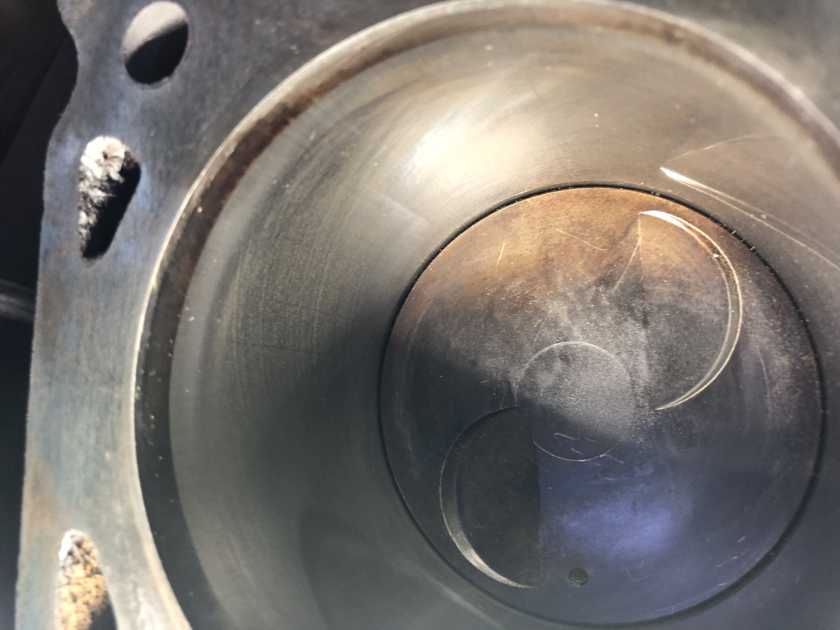

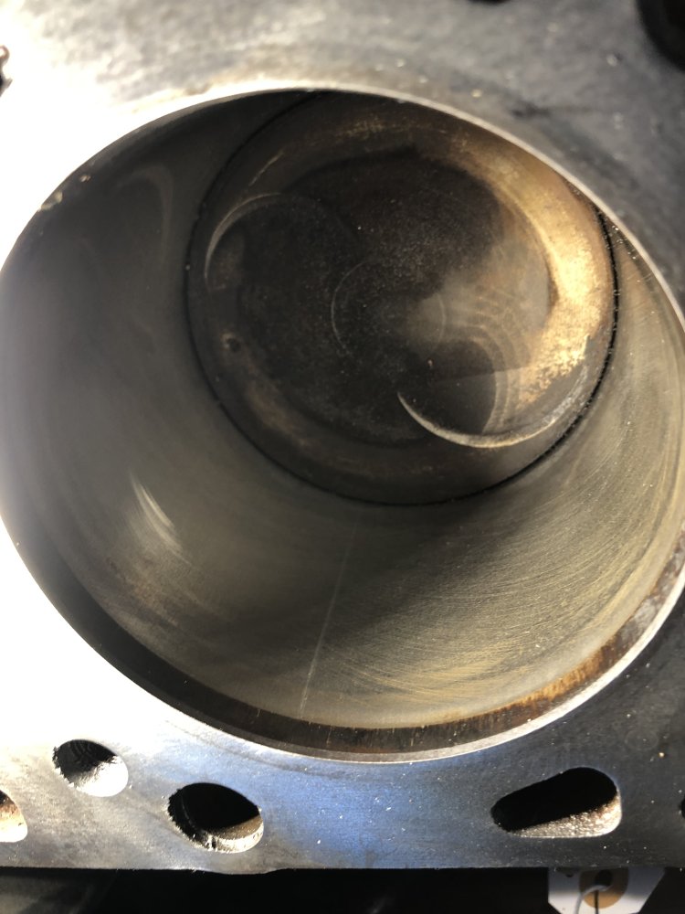

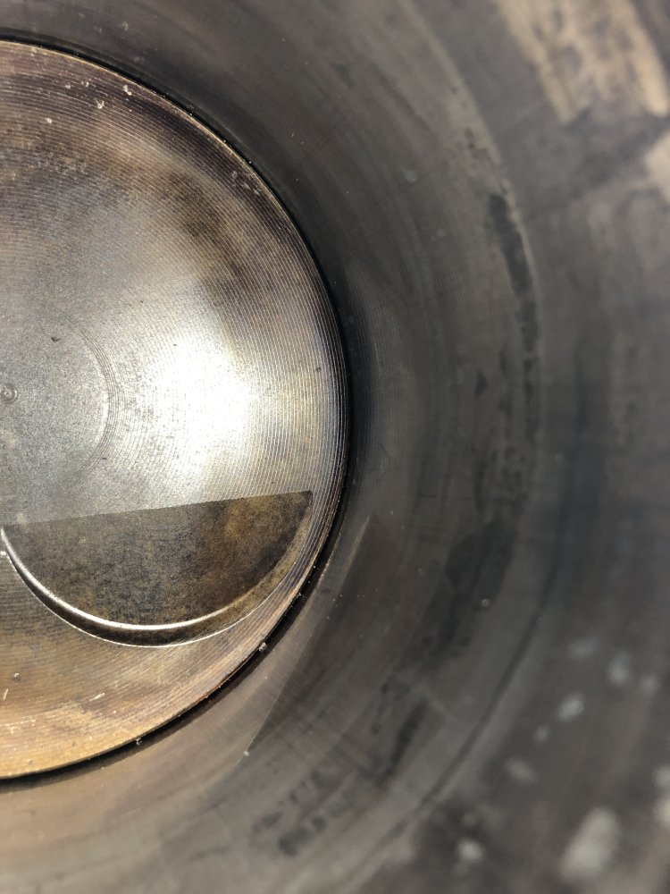

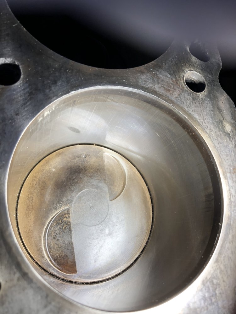

Alright, here I am, finally got the head off and looked things over.
The cylinders are measuring within acceptable ranges on service limit tolerances, but I can only measure to the piston tops, so I'm making an assumption that the bottom half should be good. I measured all of them, then did it a second time for validation and checked the dial bore gauge between measuring each cylinder.
But here's where I'd appreciate input. Visually, cylinder 1 has a lot of discoloring and/or staining of some sort. To me, it looks like from something that sat for years without moving, but I'm also wondering if it could be from the overheat incident. Remember, I'm not the one who melted it down, I bought it this way so details are scant. What I know is, it overheated and he drove it about 10 miles piping hot, then parked in in the work parking lot where it sat for a few months. I'm wondering if water was in Cylinder 1 when he parked it and it caused that discoloring? It doesn't look blue, it just looks like a dark stain, but it's hard to tell for certain. Opinions would really be appreciated. You can also see what looks like visible scoring in some places, I tried to take the most unflattering pictures I could using the light. You can't feel any of it except above the ring ridge where it's a little rough, which I write off as pretty normal. Also to note: the #1 cylinder (the discolored one) was washed clean in the exhaust port and header, so for sure it was pumping water through there during combustion. the other three looked pretty normal other than maybe a little rich in cylinder 4.
Measurements (top half of cylinders only, it's all I can do without pulling the pistons):

Cylinder 1. Note the discoloring (none of it is detectable by feel or with dial bore gauge):
Cylinder 2:
Cylinder 3:
Cylinder 4:

that staining is smooth and you cannot feel it, even with a fine tipped scribe? i feel like its probably ok but let some guy with more experience answer as i have only done overheat related overhauls on two or three engines and i cannot recall if they have discoloration in the bores. (been a number of years)
The staining and weird splotches, no. Completely undetectable.
The vertical "scoring", almost all of it is the same, can't feel it at all. There are a couple of lines (as in 2) in various cylinders that you can barely tell are there with a fingernail, but it's so slight that you have to keep going back over it and questioning if you really can tell it's there or not. It's very minor, I'm not concerned with them at all.
To me, it's difficult to not do the entire thing. I always insist that if I've got it this far apart, do it right. I just don't want to be silly and needlessly spend another 1500 bucks boring it and buying all new innards if it will go the distance as it is. I mean, I still may wind up deciding to do that, I'm waiting to see what others think of it and get some sort of consensus first.
