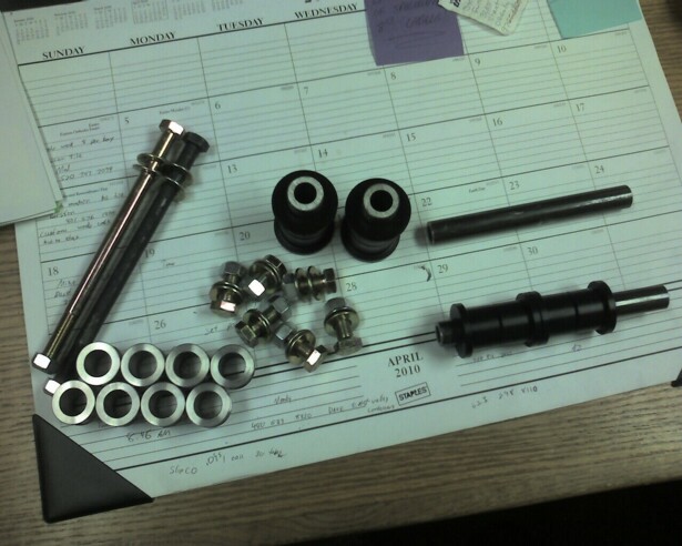

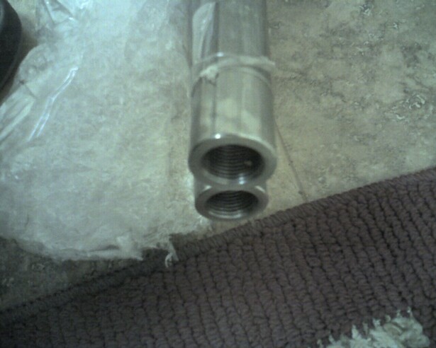

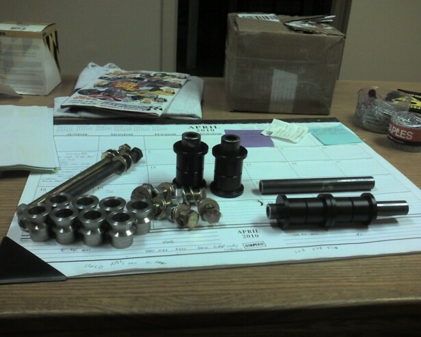

Yay! all the steering parts and my shackle bushings are in! One thing i really like that dave does is he uses the 7/8 heim, in doin this with the size tie rods he uses you tap threads directly into the chomoly tie rods instead of welding in a bung and having to use a smaller hiem like a 3/4. Hopefully if extermination of the termites at the building i work at doesnt take all weekend ill have time to tear into the ranger! :yahoo:

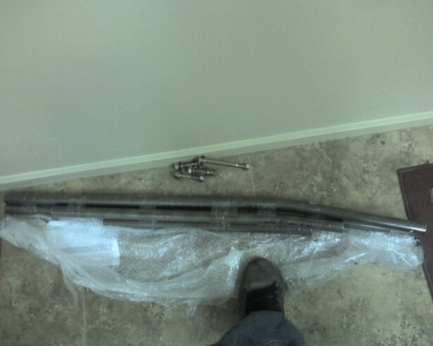

and the new beams that will be going on tomorrow! (not shown are the d44 knuckles and heims :icon_hornsup:)

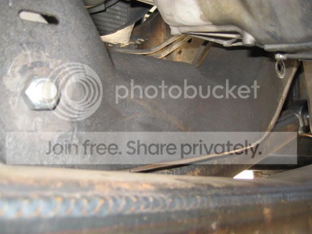

Awesome!! Just a reminder for you on trimming the engine crossmember for clearence for the passenger side beam. Trim it all off like in the pics and you will be good.

Yes sir! that was the first thing i did this mornin. worked out perfect first time through too!

This is the first ive ever heard of something like this. why did you trim it to begin with?
