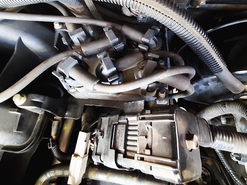

Where is it located? I never listen to the radio, so I could run it unplugged forever and not miss it.
See the pics above. The Cap is usually bolted to one corner of the CoilPack, & plugs into a 1pin harness socket.
