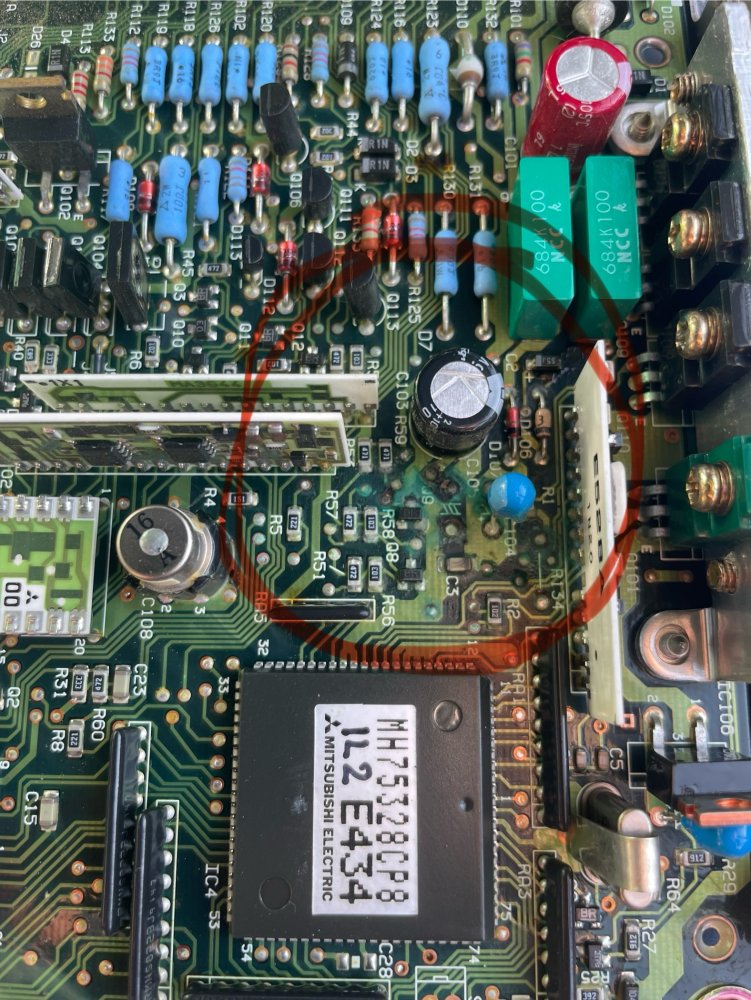

I tried key on engine off; I’m not too familiar with the obd1 system (probably doing something wrong) but just to clarify it’s the one pin connector on the passengers side rear engine compartment that gets grounded out to pull codes? What is the proper procedure if you don’t mind me asking? I also pulled out the ecm today and found a capacitor had leaked onto the board…
Idling and highway issues
fuzzy death.....bummer.
thats the mecs system right? maybe pop a cap in its arse and get it going
Definitely fix those capacitors. It's also good to know how to pull the codes when you do your own work.

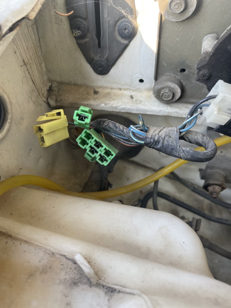

I think I’ll look into replacing or repairing the ecm whatever is cheapest; here is a picture of what I got for the connector I should supposedly ground to get codes, looks a little different than the one that you are to jump in the link.

I think some of the people trying to help still haven't realized that this isn't like our Rangers very much at all.
It's a pre-ford Mazda B-Series. Like this:
