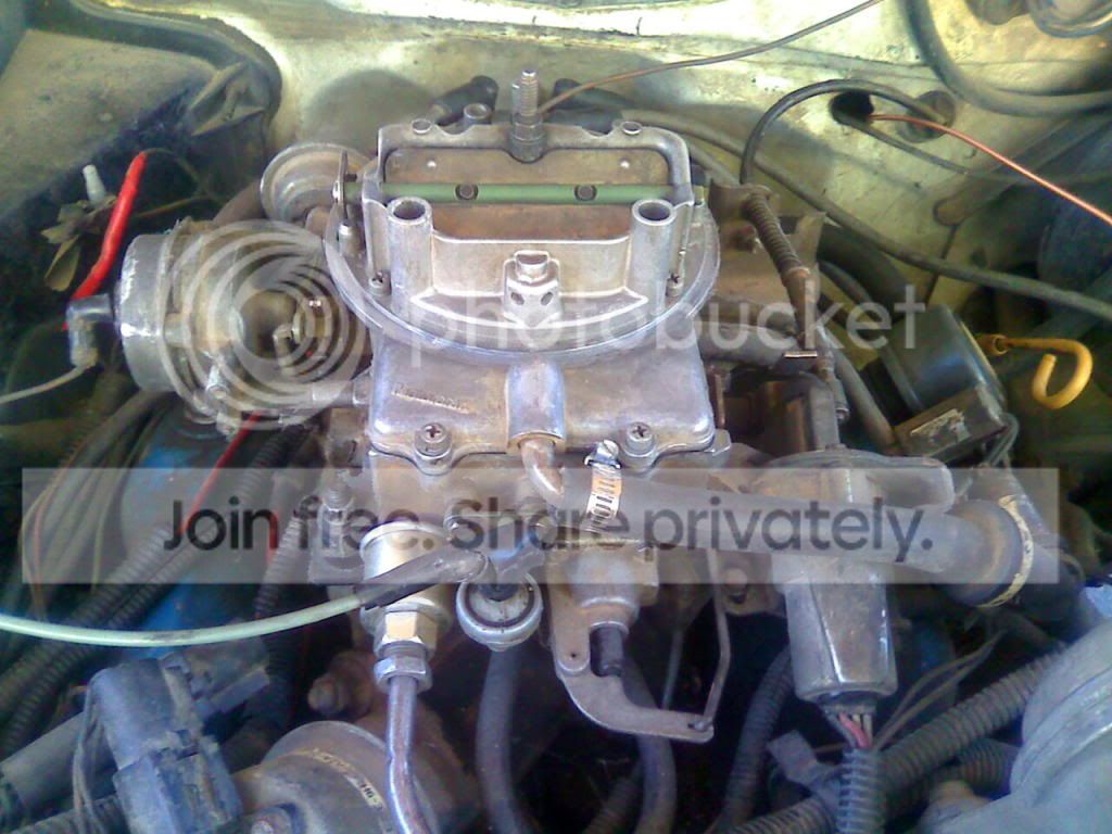

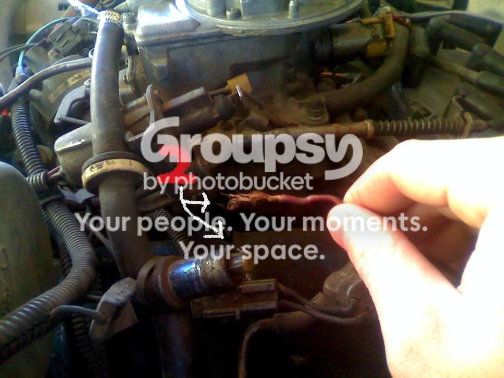

Hey, These are pics of the carb and what I have hooked up so far. Like i said it idles but has no power when i give it throttle. It sounds like its sucking air but the rpms aren't raising it seems. The jets aren't clogged but im thinking im missing a hose or something needs to be replaced. please help thanks.

2. I understand things like this need to be replaced but could this be the problem even if i had it connected and taped with electrical tape?

try this on the choke trermostat, losen the 3 screws and turn it probably to the right till the chok opens. about the other two im not sure if theres supposed to be anything there. and that wire wont make any differance if its just wrabed and taped back together. or better yet soldered. i could take some pics of mine if you want me to just pm me.
Number 1 is your fuel vapor charcoal canister, on my 2.9 it is capped off with a knob looking thing. Try putting something over the hole.
Going to work on the b2 this afternoon. Will try putting something over the hole and spraying starter fluid around the carb not in it. To check for a vacuum leak. I'll keep you posted
Yep...and the cap that is supposed to be there is kinda shaped like a mushroom & looks like it acts as a "breather" of some sort. I assume it is there to keep the canister from filling with water.
#1 & #2 unfortunately will not have anything to do with your problem I don't believe, they work together to release excess fuel vapors.
