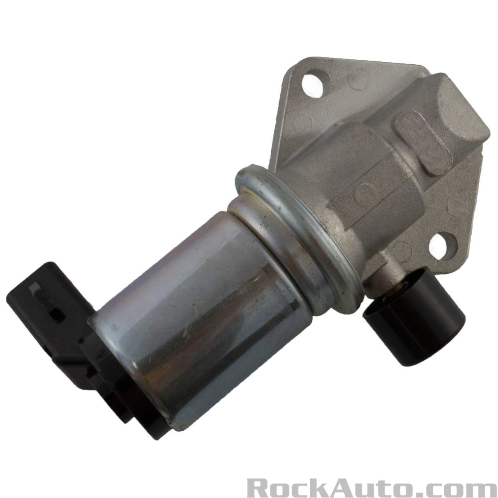

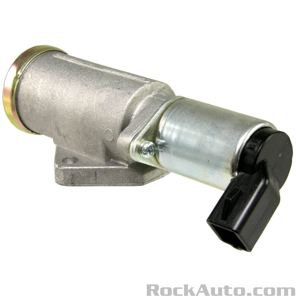

I'm looking to order a new IAC valve. I see two choices. One that comes with a round plastic black thing, like the one on the engine, and one without that. Both are listed as valid parts. The one without is cheaper. What does that thing do and is it necessary? Here are pics of the two.

The black plastic cap covers a vent, you need that on any IAC Valve
