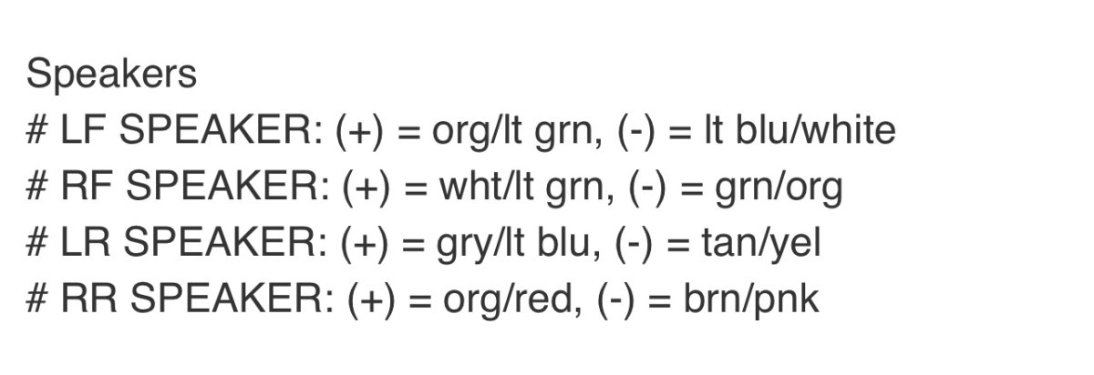

This was the correct way for my ‘99. Luckily this was the method I followed before finding the other way.
