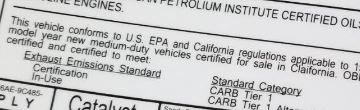

Where your sticker says "U.S. EPA Regulations", it would say " and California Regulations"
or something like this
