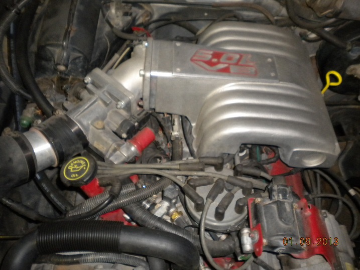

DSCN1619.JPGAlso make shure the IAC is not flipped 180deg like mine is currently (not by choice). Engine vacume can pull it open causing high idle when unplugged. Mine will idle @ about2500 unplugged, it works OK plugged in but does hunt a little when first started. I will pick up and try a SN95 IAC some time before spring, that hopefully will solve the surge.
View attachment 9064Also make shure the IAC is not flipped 180deg like mine is currently (not by choice). Engine vacume can pull it open causing high idle when unplugged. Mine will idle @ about2500 unplugged, it works OK plugged in but does hunt a little when first started. I will pick up and try a SN95 IAC some time before spring, that hopefully will solve the surge.
It isn't flipped. Mine idles at about 2700 now until it warms up. And for that period of time it is putting out enough power to pull itself 45 mph in fourth gear with my foot off the gas... which is awful driving in traffic.
