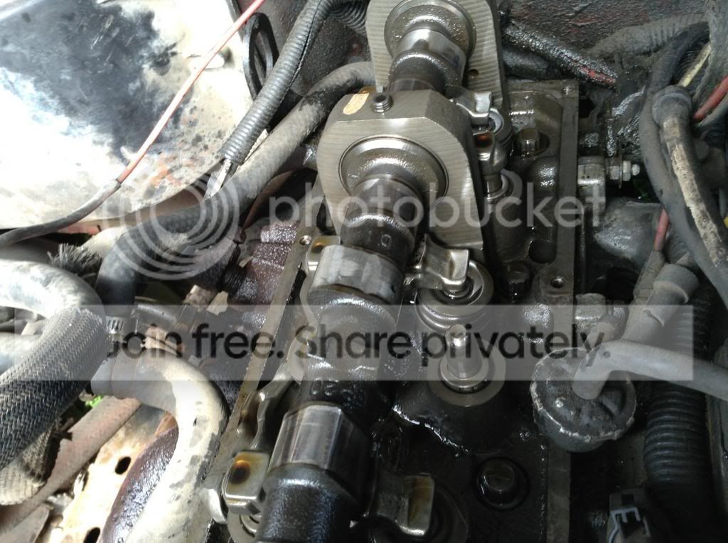

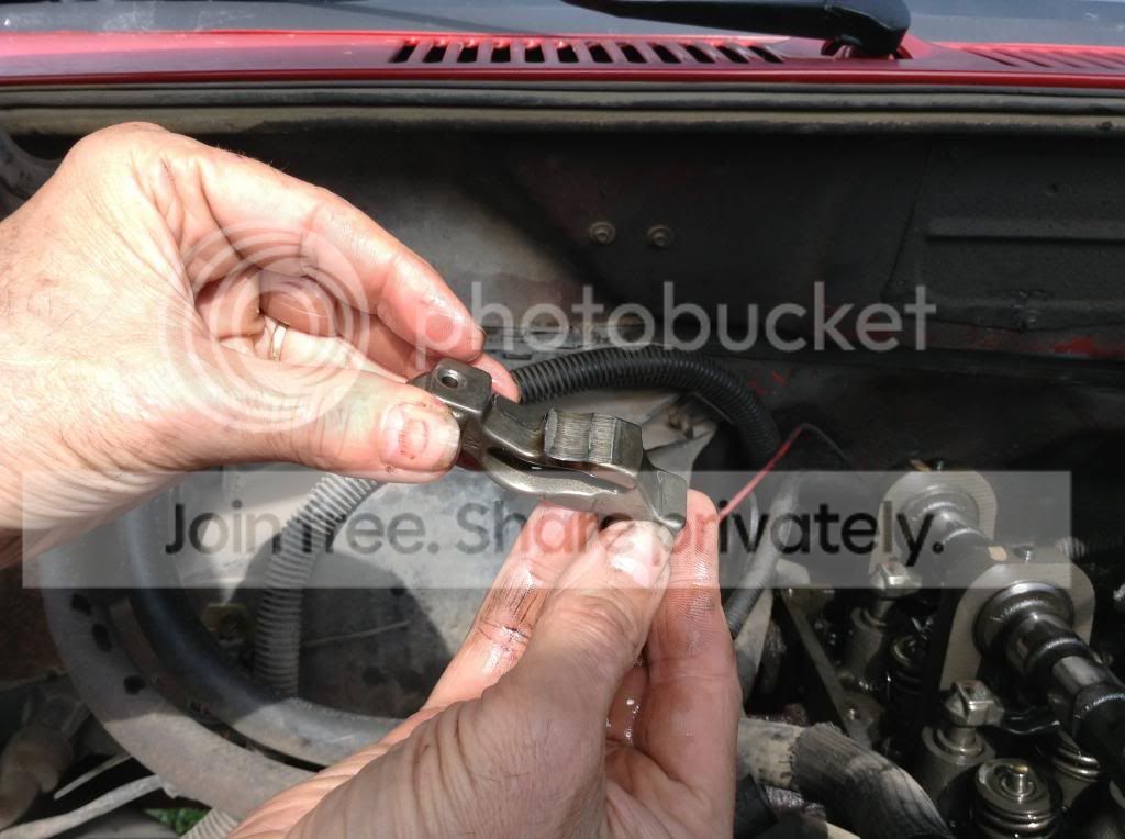

The full extent of the damage... On a related note, i found a deal on a factory roller cam and follower set from a newer ranger... So it might get put back together semi stock...
I have a factory roller cam and follower set from a 94, as well as good lash adjusters(4 of 8 are rebuilt)... What else would i need to complete the installation, other than a VC gasket and an oil seal? The timing belt is nearly new...
All you need are the cam and followers to swap to the roller cam, if you are in it that deep I suggest doing valve stem seals if you have an air compressor...
That very reason is why I swapped to a roller cam on my turbo engine...
I dont have an air compressor, hence why i am just doing the cam and follower set... I will get new seals when i upgrade the head, lol
