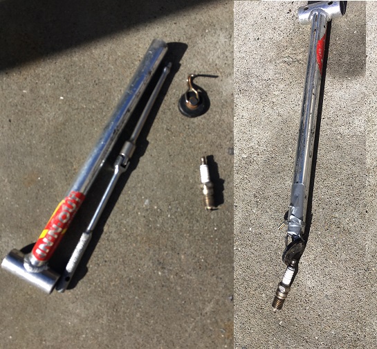

I made this tool to extract plug 3 & 4 cuase i lost the rubber gasket to my sparkplug socket :p
