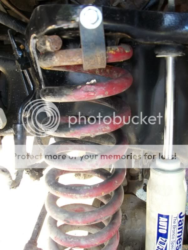

so far on the driver side i found that the top of the coil was almost popped all the way out of the bucket. i had a feeling it would be. i was going to put one of those J shaped retainer things on there anyways. Took my hub apart and found that the outer wheel bearing is shot.
after i snapped the pic i turned the coil more to make it sit flush in the bucket and rattle caned everything black.
