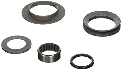

Now the issue is the SBK4 spindle bearing... I can't get the slinger onto the axle-shaft, nor can I find any info on *how* to put it on, except that it's 'press fitted'. I did see a youtube video with a guy using a pair of vice grips and a brass punch - this did not work for me, I guess I lack the skill for it.
This is the kit I have, the slinger is the one on the top left with the lip on it.
This is what it's supposed to look like assembled:
attachment.php
Does anyone know how to get this on?
Without ever having done this, I would use a piece of muffler tubing long enough to go over the shaft and hit with a hammer [with a 2x4 between the tube and hammer].
That seems like a pretty good idea. I left the axle and slinger at my in-laws this morning, see if he can figure it out while I'm at work. He used to be a mechanic before he hurt his back, but he mostly worked on Asian cars. He's got more tools than I do, tho. If not, I'll try this out tonight.
You're talking about the universal muffler pieces and tube they have at autozone, right?
Any tube, be it muffler or otherwise, that will slip over the shaft and still push the slinger on.
He got it! What he did was stuck the axle and slinger in a vise for one side and a c-clamp on the other side. Got it all put back together, the truck moves again =D
Thanks for the help, everyone!
