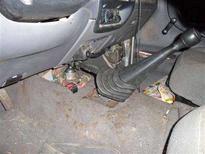

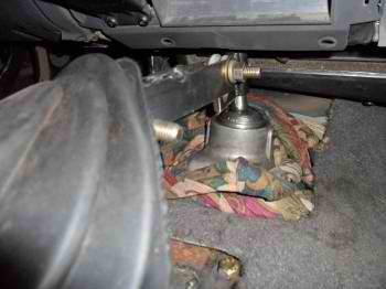

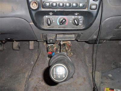

Well, here's the pictures of the stock shifter in the truck. It doesn't hit the dash or anything. Actually, the shifter works surprisingly well except for some reason I have a bit of difficulty shifting it out of reverse. It's the leveraging of the shifter, not an issue with the transmission, so I'm going to have to look into that some more. When I put the tranny in granny, the shifter is still about 4 inches away from the dash, so that is good. One thing I noticed is that the throw is fairly small between 3rd and 4th, kinda makes it feel like a short throw shifter. Not sure if I like it that way or not, so I'll drive it for a while and see what I think of it.
On another note, while I made my own driveshaft, since I didn't have anyway to really get it balanced or dialed it, I decided to bite the bullet and have a new one made. The overall length was 64 1/2 inches and I put it in tonight. With the driveshaft I made, I had a little vibration at about 60 mph. With this new driveshaft there is no vibration going 75. Of course going 75 with 4.10 gears, the engine was screaming, but everything held together just fine. If anyone is in Northern California and needs a new driveshaft, let me know and I'll tell you the shop's name. Next step is rebuilding my transfer case since I noticed that my seals were leaking. Not surprising because it sat outside in the dirt for several years until I put it in the barn, but I'm actually impressed at how smooth that transfer case runs.
I'm getting wierd looks from some people now when I back out of parking spots-hehe. Guess they aren't used to Rangers backing up so slow.:D
