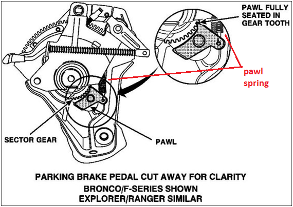

Welcome to TRS. Sounds like your issue is probably in the parking brake pedal assembly. Best thing to do is to get under there with a good light and look closely while pushing the pedal by hand.
First thing I'd check- find the pawl which engages the teeth on the gear. Make sure that its spring hasn't broken, and that the parts that should move, can move. It can be broken or worn parts, or something as simple as hitting stuck parts with a shot of white spray lube.
It'll be kind of hard to see everything, in place, and removing the assembly ain't the easiest thing. But, you're absolutely right in needing a good parking brake with a manual. Worst case, find a good pedal assembly in a junker, and swap it out.
Diagram is '93-'94; your '92 will be similar.

Sounds like a broken spring on the pedal assembly. Those drawings above should be helpful.
Have you tried cursing at it?
If you're junk yard savvy it's not hard to just replace the whole dang pedal assembly instead of trying to find the correct springs to fix your current one. It's only held on by 3 bolts, 10 minute job at most.
