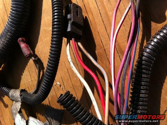

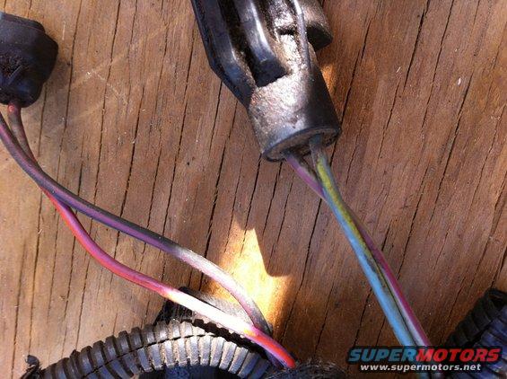

Sorry to bring back this old business but I am trying to wrap up this trans swap. I am down to the wiring and I need help verifying what I have and what needs to be spliced.
This is the harness from the manual trans:
This is from the auto:
Which colors go to what? from what i have studied in the EVTM the pink/orange and black/pink are a direct splice between the two connectors but the others are a bit more vague/hard to find. Thanks again for all the help.
