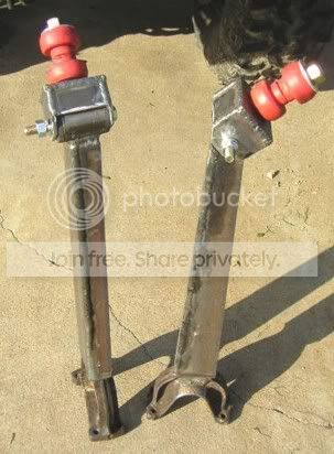

and yes, it'd be like a pivoting radius arm setup using ford radius arm bushings.
like this
Not really a wristed arm as that is a different setup
