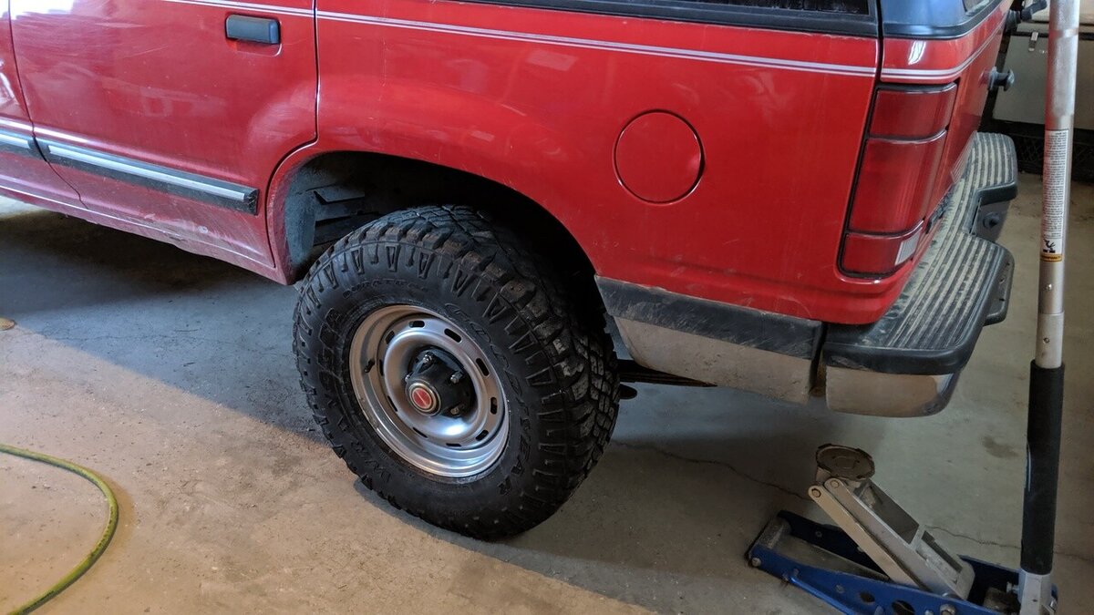

If you don't mind using adapters to get to 5x5.5, the options open up significantly. Willy's trucks had some very narrow 16" wheels, as did some 60's and 70's half ton Ford trucks. My buddy has a set of Ford stamped wheels that are something like 16x6's or 7's. You can also source 16" wheels off of mid-late 90's Dodge half ton trucks and Ford half ton vans. One of my neighbors down the street put Dodge wheels on his Explorer using adapters:
