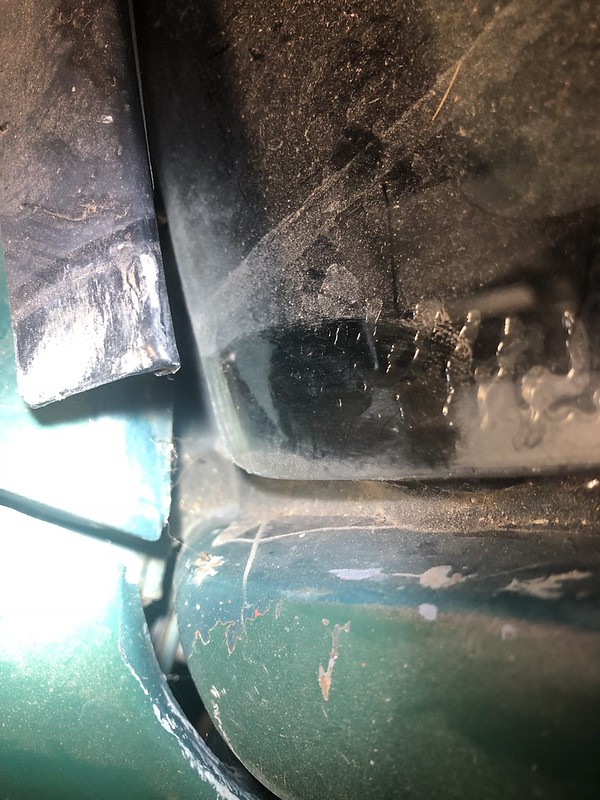

Where was your water leak coming from? Cowl? Mine's plugged up full of pine needles.
IIRC there was more than one style of "early" crossmember and it depended on what trans you had - I THINK that the one I have pictured came from the same B2 that my C5 came out of... but I have had it a LONG time and probably parted out several '85 B2's, so who really knows now.
Mine was originally an A4LD truck, mine had two holes in the C5 position too. I wonder if the BII was different than the Ranger.
Unsealed seam under the windshield trim on the bottom of the DS windshield. Looked like a out of sight cab seam that the sealant dried up. Leaked down inside the torquebox, rotted it out and then ran out on the floor and rotted the floor pan out. Rubber floor was always dry so I had no idea it was going on. :sad:
My cowl is in great shape, I try to remember to clean it out once a year. As you know it is a common weak spot on the first gens though and is kind of a complicated area to try to fix.
How'd you end up fixing it? Can I remove the trim and squirt a bunch of urethane in there? I have two 1988s that leak there... my '86 stays dry but the dang sunroof I put it drips quite a bit :rolleyes:
Yeah, it was under the windshield trim. Your results may vary, it was just a little spot I added sealer to. I pulled the carpet up every time I washed the truck or it got rained on after and it stayed dry so I think I got it.
EDIT:
Fender and A-Pillar are on the bottom, cowl and windshield are at the top. The gray blob kinda where everything meets is the sealant.
