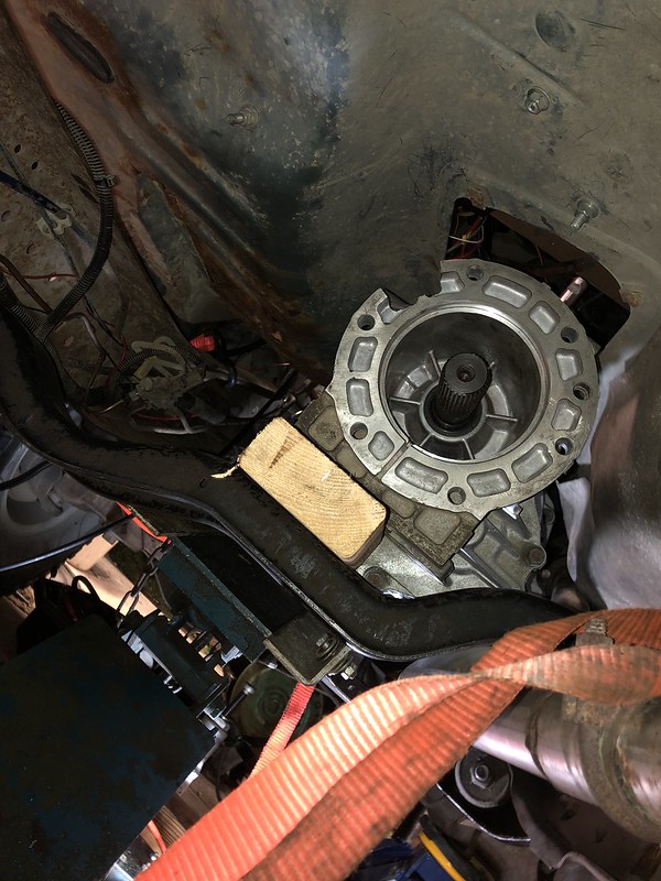

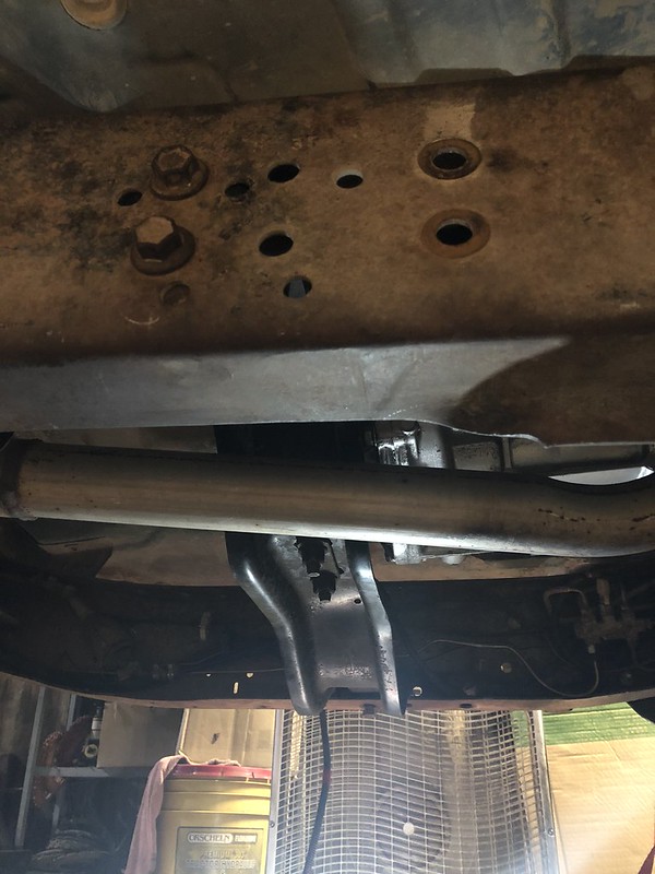

Up to '85 they looked a lot like the later one but bolted on the inside of the frame rail with two bolts stacked vertically.
I moved mine back from the C5 holes (factory) to the A4LD holes (where it was with the 2.8/A4LD)

I don't have a pic of mine loose, I added a few more pics to my previous post that show it better without derailing Shran's thread too much more. It comes down from above on the PS which is different than the newer style.

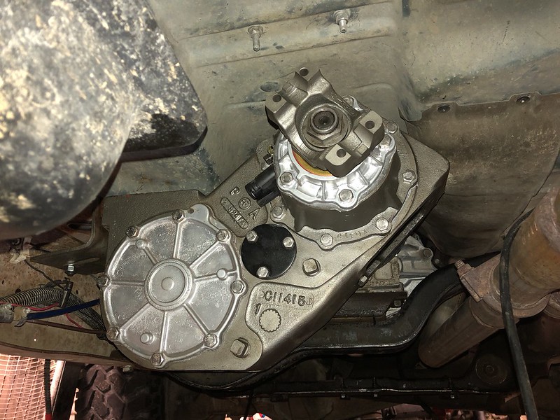

That's a pretty transfer case you have there....
