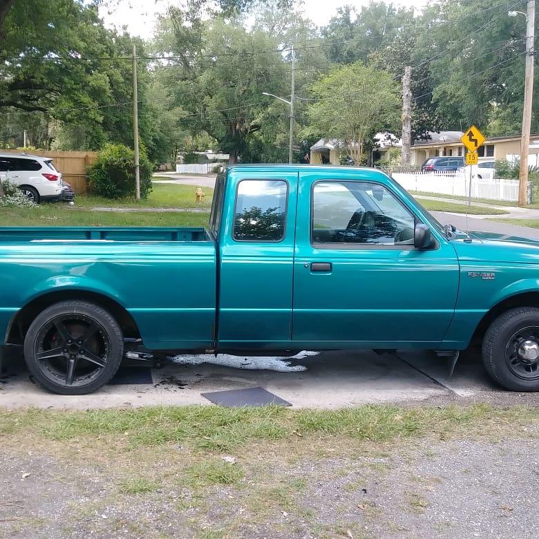

I guess i forgot to mention my build truck is a 97 ranger xlt. 2.3 manual trans. ( building a spare motor for boost. ;} )
Assuming you have the same body configuration on both trucks just swapping bodies and the rear axle, would be about 1/100th of the effort.
Negative on that one. The newer truck is a single cab ( the only reason i didn't fix it.)
My drivable truck is an ext cab.

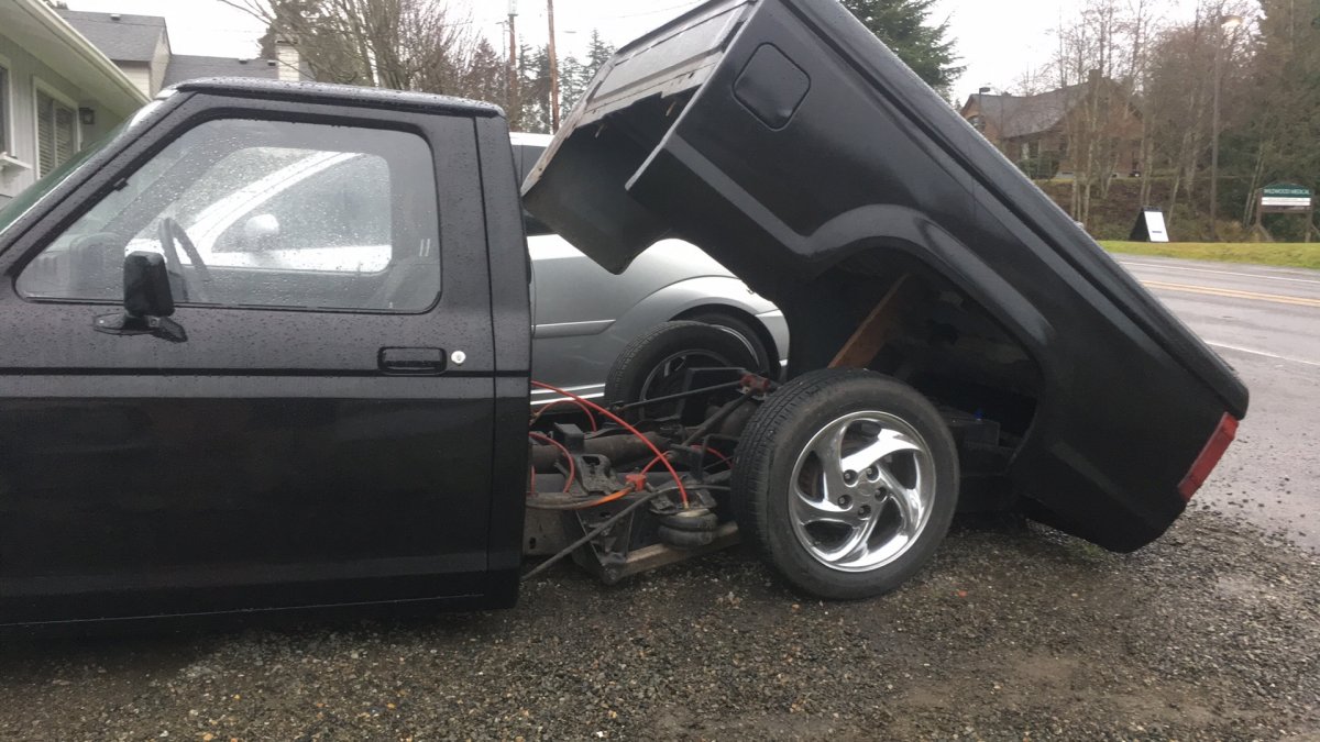

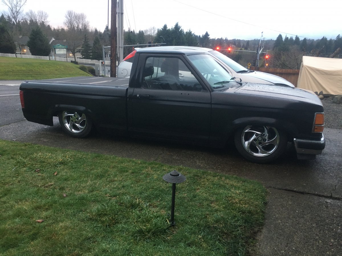

This thing drives amazingly on the freeway. Its bagged on Ibeams and the only thing keeping me from going lower is the frame. Which will soon be modified. But I have to say, The rear triangulated 4 link I fabed in rides better than I would of imagined. It rides better than It did stock for sure.
View attachment 54084View attachment 54083
Any more pics of the 4 link? I have ricks rangerz parts to bag my beams too, did you pie cut your beams to help with camber any?
