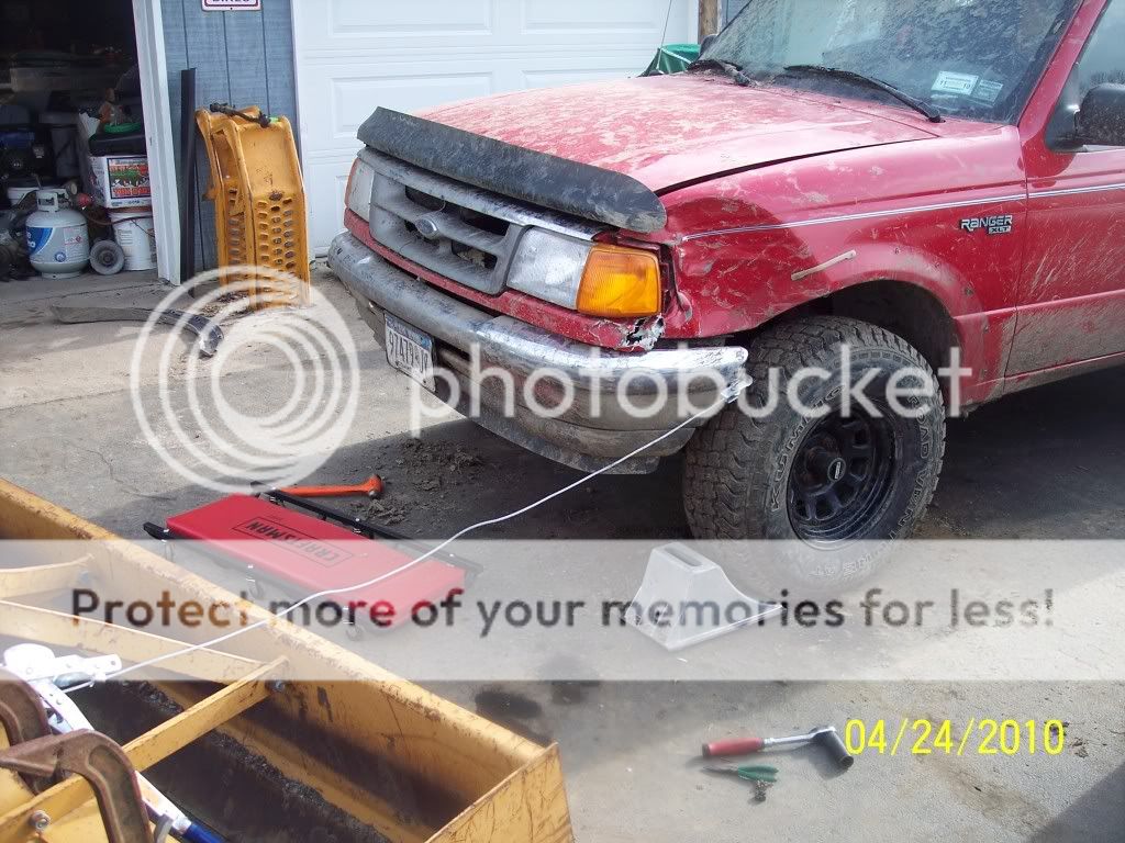

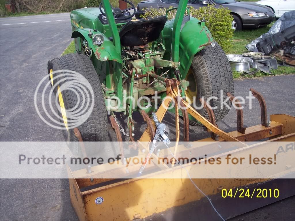

home made bumper straightening
^ lol I did that to a few rides of mine before whatever works right mine finally broke and I need to straighten my rear bumper
