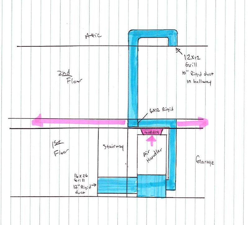

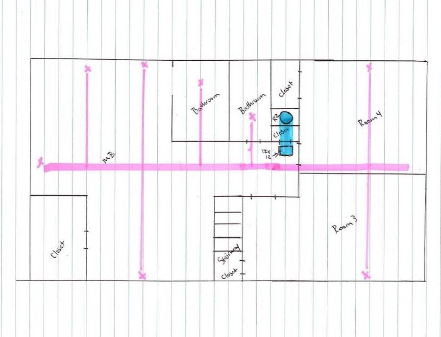

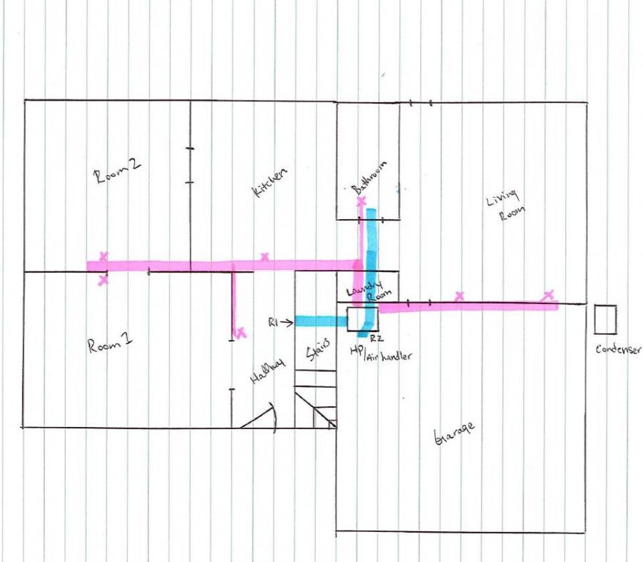

The unit is a Trane 3 ton electric heat pump with aux and the condensor is a Trane XR13. I don't have the exact model of the air handler on me but I can get it of need be. The house is two stories and is almost all rigid duct between the floors. There is are two returns as well. The return downstairs is a straight shot to the air handler plenum. This return is 12" diameter. The return upstairs starts out as 10" rigid duct in a hall, then goes in to the attic and makes a U turn down a wall between two closets. When the 10" duct meets the first floor it changes to 6x12 square rigid (I think because of the tight spaces with the supply duct. The 6x12 then enters the garage and connects to the air handler plenum. I've done my best to draw out the supply (red) and return (blue) and how the second floor return snakes through the house. I don't see any way to upgrade the second floor return because of closets and wall construction. Even if I could, it runs in to the 6x12 return and that would need to be upgraded too. I was thinking about upgrading the return downstairs from the 12" to 16".
A lot of things I read indicate I should 400 CFM per tonnage for return, therefore I would need 1200 CFM. Mathematically I should be seeing around 765 CFM, but realistically I think it is a tad lower because of all the bends on the second floor return. I get this arrive at this number because the 10" duct upstairs should flow at 240 CFM and the 12" duct downstairs should flow 525 CFM. My thought was to change over to 16" flexable duct (the air handler plenum and return plenum are not perpendicular or I would use regid) which flows 1000 cfm. Between the two returns I should have a little over the needed 1200 cfm return air.
My questions is, do you agree that the reason the condensor fan is shutting off is because the supply is too low? Do you also agree that this hasn't caused damage?
Next, do you think I am going about this the correct way or is there a better way to do this?

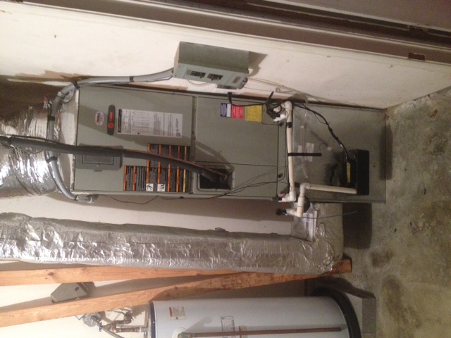

If your saying the fan on the outdoor unit is cycling off and then on and the compressor keeps running the defrost control board would be suspect. The first thing you allways check is air flow indoors and the indoor coil is clean. For a three ton heatpump you need 1200 cfm airflow across the indoor coil. Pull the front off of the coil in the air handler. I use a long bristle bottle brush to break the big stuff loose and carefully shop vac it out. Then with a pump bottle with simple green rinse the coil down good with fresh water. If it is upflow the bottom of the coil needs cleaned on a down flow the top needs cleaned. Use a wet vac to suck up the water and to clean the condensate trap/pipe. Once your sure you have proper air flow across the indoor coil. Are you getting frost on the outdoor coils in heat would be a sign of being undercharged. When the outdoor fan turns off and the compressor keeps running check to see if the emergency heat strips are on the thermostat should say em-heat or aux-heat. Anyway if it keeps cycling defrost the large copper tube will get cold it could be the temp senser out door of the defrost control boad going goofy. Give me the model numbers of the air handler and heat pump I can get you part numbers. I have been installing and servicing trane equiptment for 10yrs now!
To move 1200 cfm at .05 static pressure you need 17 inch round pipe or 10X25 rectangular duct. A 16 inch round pipe would be sufficient. That is .05 inches water column on the furnace side of the air filter.
Looking at your third diagram are you saying it has a 12 inch round off ths side into the bottom floor and a 10 inch pipe up in the attic? If so it is definately high on static pressure and not pulling enough air across the indoor coil. If you can increase the return downstairs to 14 inch and 12 inch in the attic.
Especially for the summer months the more return you add upstairs the cooler your house will stay so keep that in mind.

Regarding your 3rd reply, that is correct. There is a 12" return off to the side and a 10" in the attic. Ideally I would like to increase the return in the attic but I may not be able to because of the surround walls.
What would be the biggest downfall to not upgrading the attic return? a warmer upstairs?

Yours being a upflow you may need to either cut a access panel under the furnace to get up there or possibly pull the coil out if the lineset can be bent out enough the drain can allways be refit. I am on call this weekend PM me and I can give you my phone number. You cant increase airflow upstairs can you increase return downstairs to 14 inch that will give you around 1000 cfm across the coil.

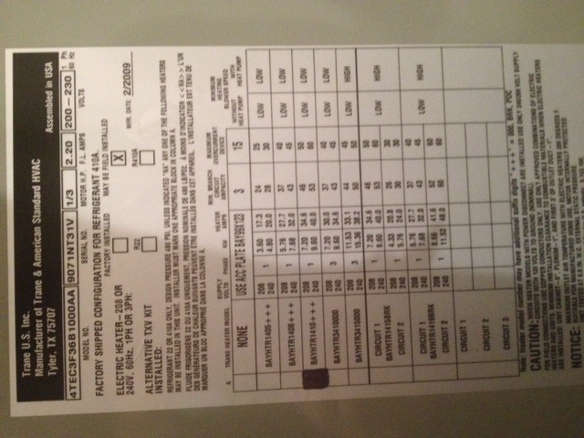

You have been a wealth of knowledge, thank you for your help so far. I got the model numbers from the air handler and from the condenser.
First thing this morning I've got some flashing to fix while I've got some nice weather. This afternoon if time permits I will double the coil and make sure it is not icing up. The weather has been pretty nice lately so I haven't been running the unit too much. I'll try to get some more details this afternoon and post them up.
