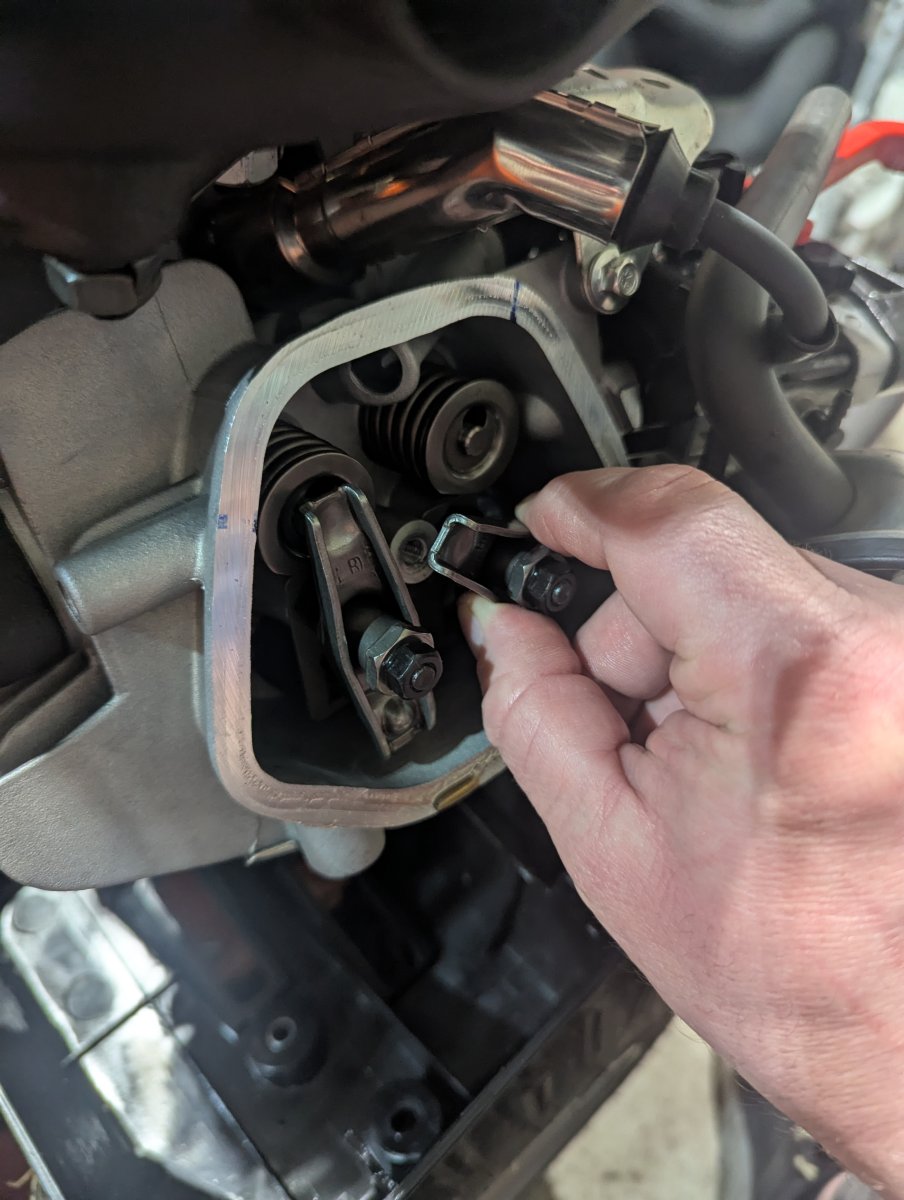

I have a 3 year old Husqrvana and it's been used once. Last year I go to start it for the season, and it won't fire, has spark, is getting fuel. I pulled the carb off to clean it, found both of the gaskets are rotten and blown apart. When I'm putting it back together I broke the stud off just using a 3/8 ratchet. I kick it a few times, and we never got any snow, so now it sits for until this season. I put the new stud on, to go fire it again, same issues. But now I'm looking at the fuel line is cracked and leaking. What a total piece of shit
Now I've got a snow blower I've used twice that won't turn over, even on starting fluid. Just get some backfiring from it on that. I feel like I had to have missed something obvious, but I'm too full of rage at it to look at it calmly and rationally. Anyone has any suggestions, I'll take em

Backfiring like crazy
Fresh gas, cleaned out the carb
That makes me wonder if your intake valve is sticking. Or the woodruff key on the flywheel has sheared off and the timing is off just a hair. Not many other good reasons that it would backfire through the carb like that on a single cylinder engine.
My next thought was to pull the valve cover off and see if there's something obviously wrong, but beyond that I'll be pretty lost
This explains some more. Done with this for today

That is a very stuck intake valve

how did the carb look port wise?

I had similar issues with my Stihl string trimmer. I was about to suggest looking at the valve lash, since that is a known issue with the Stihl engines. But it looks like you found the issue.
