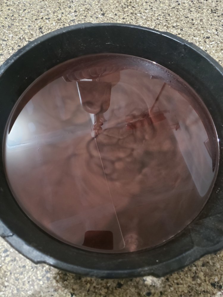

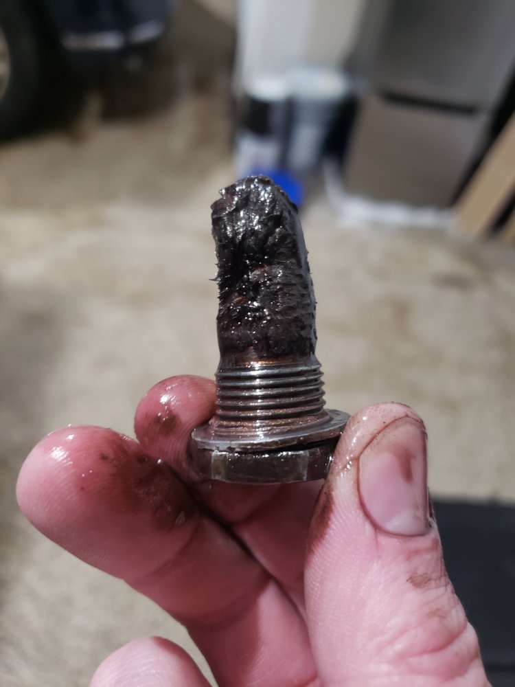

I did the math and concluded the original combo (205 tires and 3.45 gears) is roughly equivalent to the current combo (32" tires and 4.10 gears). I didn't mention that my transmission is rapidly eating itself. I excluded that to determine how much impact that factor had on my mileage without receiving unwarranted speculation. At one point I was getting 20mpg.
What exactly is the trans doing?
I cant see it causing a 50% drop in MPG.
You got any codes? Any sign of rich running? I would think dumping that kind of fuel into a 4.0 would show some sort of symptom.

Pictures attached of what trans is doing. That was after a few thousand miles. It grinds going into every gear when moving. It has some codes, but I don't remember them. I really wish Moates hadn't shut down without warning so I could get some real data! My 460 smells a lot richer than my Bronco. I know it needs a transmission. I can't decide whether to have the spare rebuilt before I install it. I agree mileage is unbelievably low: the worst I ever got in my 4.0 SOHC Explorer was 11, and that was pulling ~3k into a 40mph headwind.
