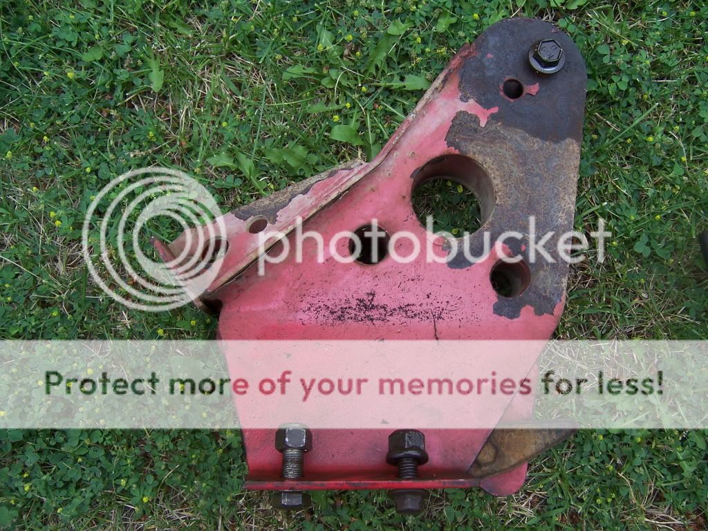

hey guys i was wondering if anyone knew how to tell what size lift i got by maybe measuring the lift bracket?

Better off posting a picture of it here.
TRS members can identify lift brackets like nobodys business :D
The brackets are for both (notice the two holes for mounting the axle ).
Measure the coils.
IIRC, the 4" lift coils are 17" long, the 6" coils are 19" (out of the truck).

nice find on the brackets btw.....:icon_thumby:
just make sure you get longer brakelines and shocks.....also did it have a drop pitman arm???

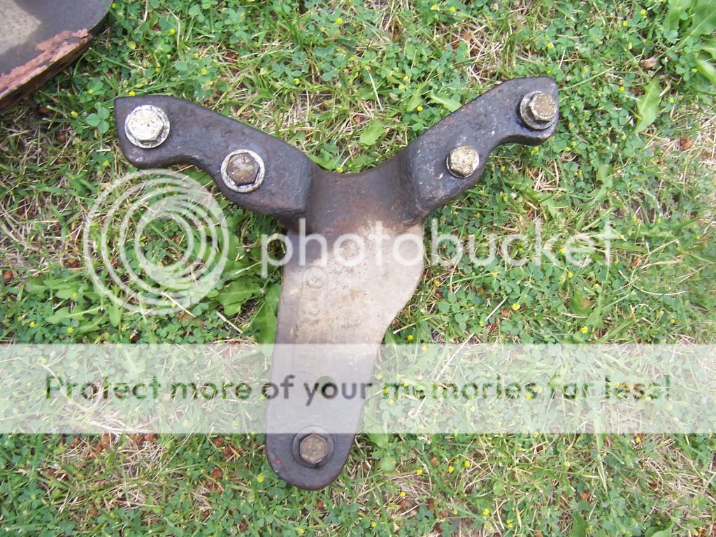

hello again fellas, i have been reading up on the guys who have been doing four inch lifts with six inch coils and some people have said that if you want the six inch lift, you need a special extreme drop pitman arm that don't come with the lift. well, i went out and looked at my lift to see where the brackets were mounted and sure nuff they were on the six inch hole. Now my question is, is this the right "extreme" drop pitman arm for the six inch lift?
thanks in advance
