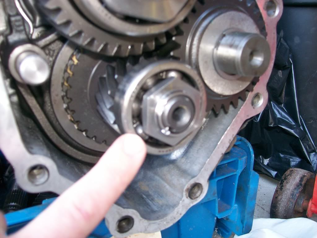

4) Remove the 55mm Nut. You will need either a large pipe wrench, a hammer and chisel, or the special tool that was made to do this (pic avaliable upon request). This nut is staked, so its gonna take some effort to get it loose.
5) Remove the smaller 30mm nut. Again, its staked
6) Remove the small bearing and washer.

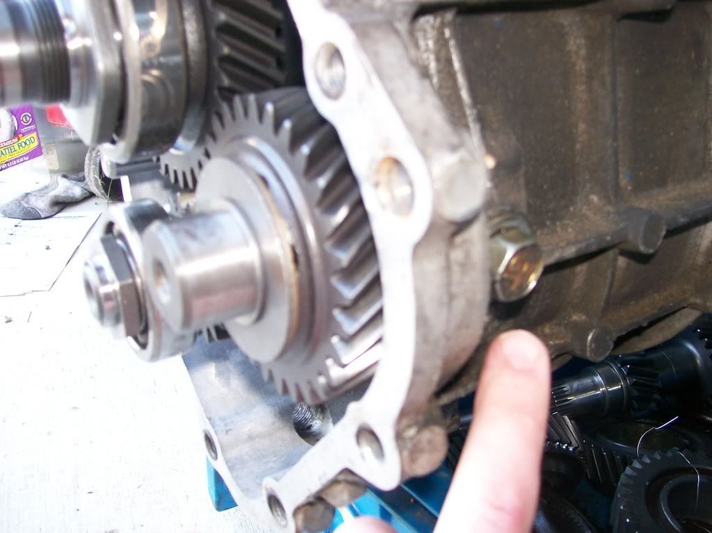

8) Place a pry bar between the rear bearing and gear. Firmly but gently hit the end of the output shaft while prying between the 2. Rotate the out put shaft 1/4 to 1/3 of the way around, and repeat untill the bearing comes off.
9)Remove the large gear behind it, and then the 17mm bolt that holds the reverse assembly in. Remove the reverse assembly.

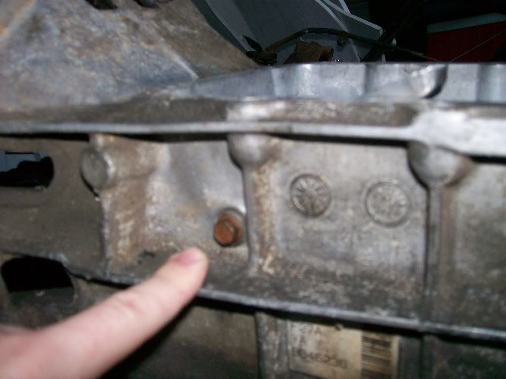

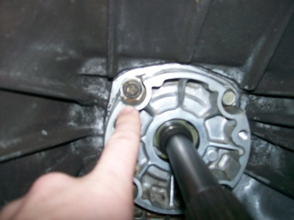

13) continue removing the parts in order till you get down to the rear bearing retainer. Its held in by 6 bolts.

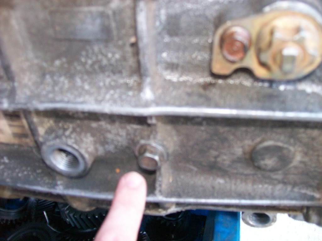

14) Remove the oil trough bolt and then the oil trough
15) Remove the front bearing retainer
